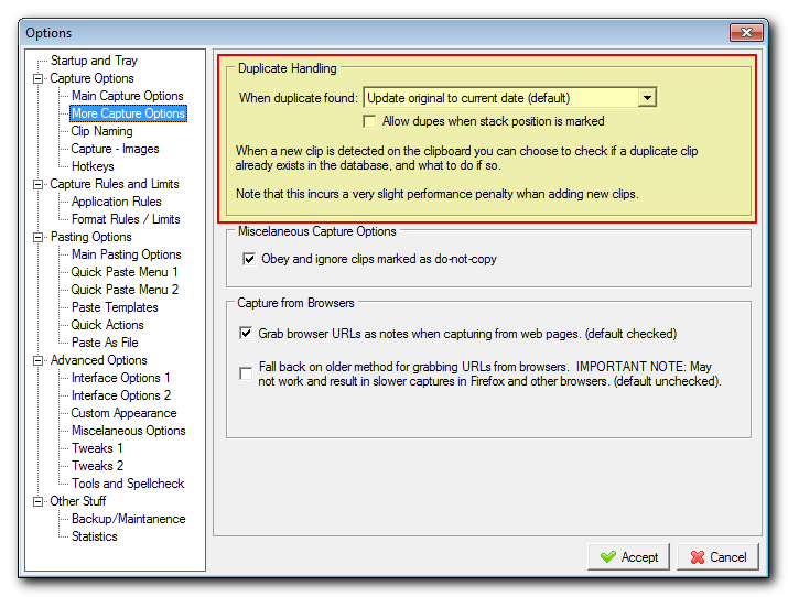

Here's something that may fix it.  I've added a new option to increase the delay between the triggering of a clipboard event and CHS acting on that trigger, so that 2 quick success triggers will only result in the final capture:
As I said earlier, the other fix which will be available in a future version of CHS will be if the clips are duplicates except for a one or two irrelevant data formats, to mark those formats as IGNORE or IGNORE-FOR-PURPOSES-OF-CALCULATING-UNIQUE-HASH.
Other possible solutions would be: Having a list of applications that CHS should increase delay-before-capture behavior, or some kind of smart process to overwrite the previous clip when the subsequent one happens in super fast succession.
« Last Edit: February 21, 2020, 08:25 PM by mouser »

With the same vector drawing and delay set to 500ms -- one clip gets copied.
So I think that probably suggests that your having that same problem with apps that put a lot of info on the clipboard where CHS first grabs the clipboard and then the app adds more info and chs has to go again.  As before, there are a couple of options here -- either forcing a longer delay for CHS from some apps, or some process where i auto-delete the prior copy when there are 2 in close succession.

I'm going to go ahead and move the clipboard capture delay option up to a more prominent location in the "More Capture Options" tab, and add an explanation for it; that will make it easier for people to notice.
