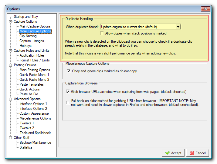

Here's something that may fix it.  I've added a new option to increase the delay between the triggering of a clipboard event and CHS acting on that trigger, so that 2 quick success triggers will only result in the final capture:
As I said earlier, the other fix which will be available in a future version of CHS will be if the clips are duplicates except for a one or two irrelevant data formats, to mark those formats as IGNORE or IGNORE-FOR-PURPOSES-OF-CALCULATING-UNIQUE-HASH.
Other possible solutions would be: Having a list of applications that CHS should increase delay-before-capture behavior, or some kind of smart process to overwrite the previous clip when the subsequent one happens in super fast succession.

With the same vector drawing and delay set to 500ms -- one clip gets copied.
So I think that probably suggests that your having that same problem with apps that put a lot of info on the clipboard where CHS first grabs the clipboard and then the app adds more info and chs has to go again.  As before, there are a couple of options here -- either forcing a longer delay for CHS from some apps, or some process where i auto-delete the prior copy when there are 2 in close succession.

Slight tweek in new update; *might* (but probably won't) improve the issue of double clips.

I found an issue that *might* be responsible for the double duplicate captures.  Can you download and try the new version and see if it still occurs even if you lower the delay to 200 or so.
:Thmbsup: with delay set to 200 only one clip gets copied.
