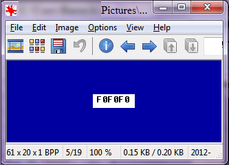

After some investigation, what seems to have been happening is this:
  • Step 1: Take an image clip with the OneNote clipping tool.
  • Step 2: CHS makes a capture "ping".
  • Step 3: A OneNote message pops up from the systray confirming that a clip capture has been made.
  • Step 4: The image is saved correctly in two places: one in the OneNote Unfiled Notes section and the other in the CHS database.
  • Step 5: After taking the clip, and before taking any other clips, I go to an existing .png file in my usual Screenshots folder, open it in irfanview.
  • Step 6: I paste the image (from the Clipboard) into the file, overwriting the image in RAM.
  • Step 7: Sometimes I adjust the file in irfanview.
  • Step 8: The image in irfanview is then saved as a new file name which is similar to the opened file name, in the Screenshots folder.
Usually, this works just fine.

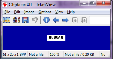

Sometimes, something different happens in step 6: when the paste is made, the paste occurs OK, but a CHS capture "ping" occurs as the paste is made.
If I then (say) paste the contents of the Clipboard again into the image in Irfanview, overwriting the image last pasted, a strange n-digit code is pasted, as for example: (is this hex?)

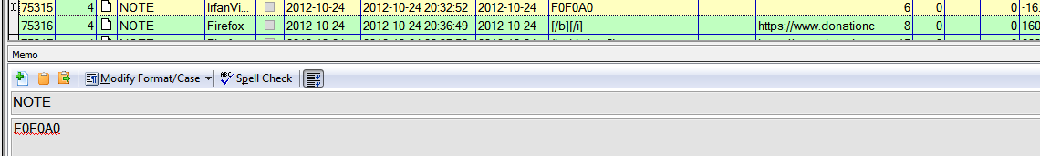

These were also saved as text clips in the CHS database (that must be why the extra capture "ping").
Notice the formatting in these images.
Here's a picture of the CHS clip record of the last image above, as it appears in the CHS database Memo and Grid.
This then seems to be repeatable, a bit like a chain reaction.
I don't understand it. Something is triggering this. I wonder whether this is necessarily a CHS problem per se, or maybe (say) something being triggered in irfanview as a pseudo "Copy" command by a field in the Clipboard.(?)    :tellme:
What is a discovery (for me) is that you can take a text clip and paste it as an image into irfanview.
(Though it apparently loses any formatting.)
I hadn't realised this before now. It has possibilities!    :)

  • Posts: 40,928
Ok so I don't have an answer but I may have another clue.
I'm guessing that that "code" is in fact a hex COLOR number.
My guess is that something (a hotkey) is causing an application (CHS suggests the culprit is irfanview?) to copy a pixel color hex code to the clipboard.
