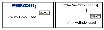

<Win>+<End> and, <Win>+<=> works if you do not include equation sign (=) into the selected formula (see the screenshort).
nogojoe, do you want to calculate simple financial expressions includes %-sign like followings?
123+53%=65.19
12*4%=0.48
I ask you, because in the long math. expressions it is important to calculate them in order of priority of the math. signs: *, / are  calculates before + and - math functions.
So I don't know, exactly, how I must to set priority for the %-sign  because, IMHO, it is a financial (not mathematic) sign.
You can take a look at how Windows Calculator makes calculations in order of math.signs (*,/,+,-) when works in different mode: simple or  scientific. In the simple mode it makes calculations in order of input, but in the science one it makes them in order of priority of the math. signs. Also, in the science mode the %-function (and its button) even doesn't exist and doesn't calculates correctly.

<Win>+<End> and, <Win>+<=> works if you do not include equation sign (=) into the selected formula (see the screenshort). (see attachment in previous post)
Thanks Wep I can works those commands OK now

Hi nogojoe
Try new WinTipCalc, which will replace WinMouseTipCalc and WinToolTipCalc.
At beginning I meant to use <win>-key only to switch NumPad-keys temporarily into the calculator mode.
But it is possible to make NumPad-keys as basic calculator input keys and <Win><Numpad keys> will be used as ordinarily <Numpad keys> if that is suitable.
I have few variants for hotkey mapping.
First one you already know.
In the WinTipCalc you can try second one:
Numpad-keys used without <Win> modifier as calculator's input only while ScrollLock is turned on. But if you want to use them as ordinarily (while ScrollLock is turned on), you can use it with <Win> modifier. Other functions used as before, excepting NumLock-key, which you can use as backspace to delete last input. I removed roundoff by number-keys, because I will assign them to additional math functions in next the release. Still you can set roundoff by <Win>+<UP> and <Win>+<Down> between 0 and 20 digits after decimal floating point.
