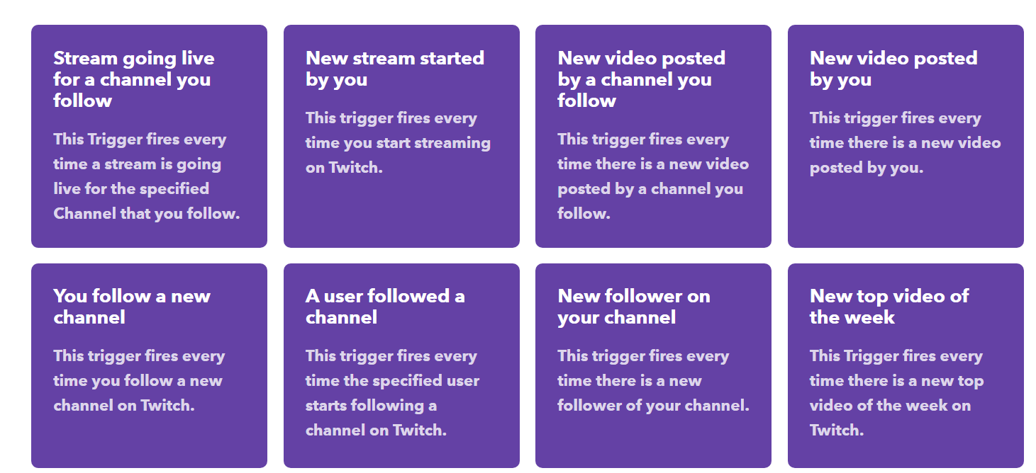

I did something similar using a hacked Amazon Dash Button, A simple smart outlet, and IFTTT.
Since you're just using twitch notifications, you don't need the button to send the signal... hook it up to the twitch actions to hit the Meross smart plug in IFTTT.
And those are just the prebuilt actions.  If you have a pro account on IFTTT, you can create custom actions, and use webhooks from the Twitch API
The IFTTT options for Twitch -
Lifx bulbs are a bit more expensive, but I prefer those to the plugs.
