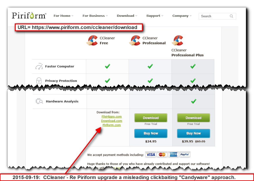

Some people (not me, you understand) might say that this could be considered as deliberately misleading, shonky and borderline legitimate commercial behaviour, and arguably only one step removed from the Candyware concept, but hey, if it gets a sale, then whether the punter bought it by mistake is neither here nor there, right? - however I couldn't possibly comment.
