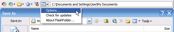

Then get and install FlashFolder (this script is tested to version 1.8.141). Once installed, you will have to configure FlashFolder. You gain access to FlashFolder and its options by first selecting to save or open a file in any application that uses the standard save/open file dialog. FlashFolder will now appear as a toolbar above the file open/save dialog. Click on the button directly to the left of FlashFolder's text-field and select "Options..." in the menu that drops down (shown in the image below).

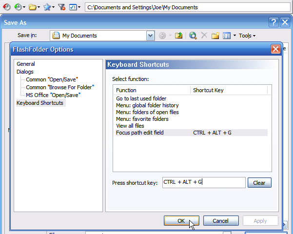

In the options, you should set the keyboard shortcut for the "Focus path edit field" to CTRL + ALT + G as shown in the picture below.

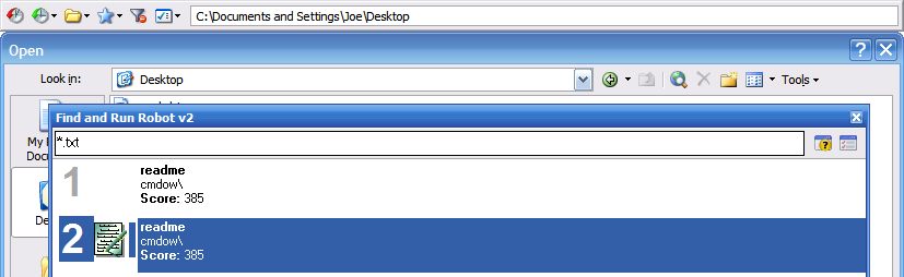

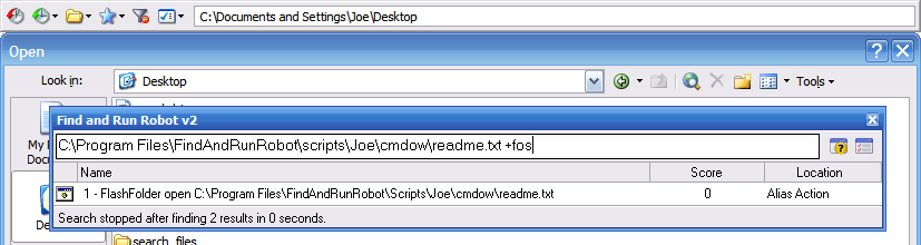

Now, finally, we may test if this works as it should. To do this, start a file/open save dialog from your favorite application. Next, start FARR2 with your favorite keycombo and type in your search terms. Using the arrow keys, select the file of your choosing in FARR2's result box and press TAB. The topmost field of FARR will now become activated again and the path of the file just selected with TAB will have replaced the previously typed search terms. Now, to send the path to FlashFolder, you will have to type in +fos after the path and press RETURN. The following two images are meant to illustrate this process:
You may also send a path to a file save/open dialog by preceding your search terms in FARR with the keyword lfos whereafter you type your search terms. The file or folder-path that you select in the result box will now be automatically sent to the currently open FlashFolder-dialogue.
