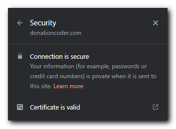

Hmm... I'm not sure what you're talking about. Nothing has changed. Mouser still owns this website. My browser says the certificate is valid and the connection is secure.
It sounds to me like the issue is with your browser. Have you updated it lately? Or perhaps tried with a different browser?

I am a dinosaur: I still use Windows XP and Maxthon 5.
I perfectly realize that the trouble depends on my system. I only want to know if I am under risk.
