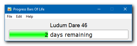

I give it some serious side-eye but I'm busy working on the game jam, so I snap a screenshot and let it slide for the time being. A while later, I notice it's about 20 minutes away from being a full 24 hours since LD46 began (meaning I should have about 2 days 20 minutes remaining), but now it looks like this:
Uh... what? :huh:
First of all, why is it telling me I have 189 minutes remaining and not showing hours? Second of all, why, when I'm finally at a point where showing me minutes remaining makes sense, does it totally omit the minutes and just round to 2 days? :-\
PBOL is weird.
But I still like it. :D

Yes. It was showing hours until about 2 days and 4-5 hours remained. I'm not sure exactly when it made the switch. But I noticed it had changed from hours to minutes when it was close to (but higher than) the 3 hours remaining mark.

I just created a timelapse from the screenshots I took and I see PBOL went from 2 days 4 hours remaining to 2 days 239 minutes remaining. Then it went from 2 days 60 minutes remaining to 2 days remaining.
