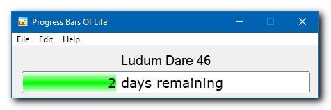

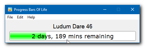

So, I'm doing my thing, crunching away at Ludum Dare, and I notice my PBOL says this:
2 days 189 minutes? Not 2 days and 3 hours? Okaayyy then... :tellme:
I give it some serious side-eye but I'm busy working on the game jam, so I snap a screenshot and let it slide for the time being. A while later, I notice it's about 20 minutes away from being a full 24 hours since LD46 began (meaning I should have about 2 days 20 minutes remaining), but now it looks like this:
Uh... what? :huh:
First of all, why is it telling me I have 189 minutes remaining and not showing hours? Second of all, why, when I'm finally at a point where showing me minutes remaining makes sense, does it totally omit the minutes and just round to 2 days? :-\

« Reply #3 on: April 21, 2020, 03:45 AM »
Does it *ever* tell you you have X days and Y hours?
Yes. It was showing hours until about 2 days and 4-5 hours remained. I'm not sure exactly when it made the switch. But I noticed it had changed from hours to minutes when it was close to (but higher than) the 3 hours remaining mark.

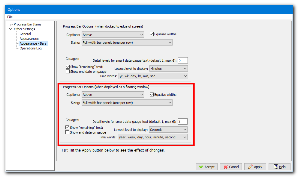

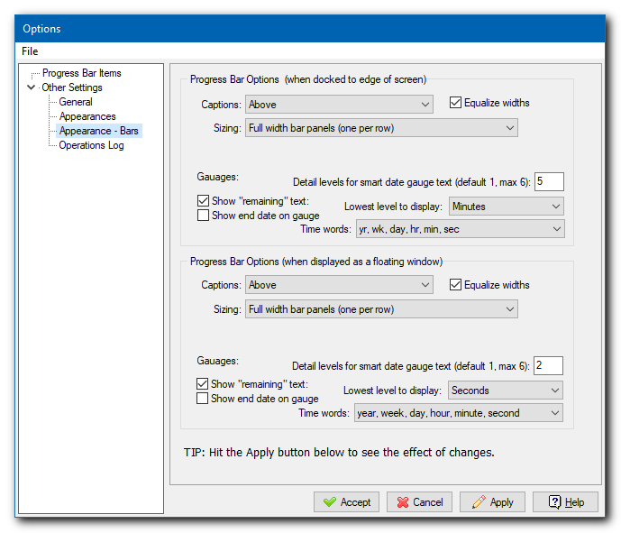

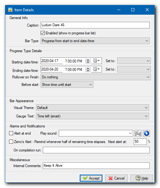

I'm looking at the code now.. Can you post me a screenshot of your options for the bar that say how many words of detail to show, etc.
I haven't tried the new version yet. I'll test it out momentarily.

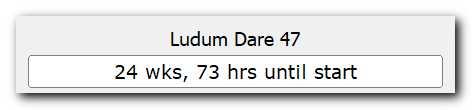

And another weird one:

Basically, I think it should never show me the next lower unit of measurement while the larger one is greater than 0. So "24 weeks 3 days" is sufficient precision. Or "2 days 3 hours" But if it's 2 days 0 hours 45 minutes, it should just show 2 days 45 minutes.
I also just noticed it is showing "wks" and "hrs" which is how it's configured to display while docked. But it's currently a floating window, which I have configured to spell out the whole words and not abbreviate them. It makes me wonder which other settings aren't working properly. :-\
Re: Weird precision (or lack thereof) in time remaining displayed
« Reply #12 on: April 21, 2020, 09:27 PM »
Uploaded new version, see if it fixed that.  I also see it was reversing when it used the docked vs undocked option for word abbreviations, hopefully that is fixed too.

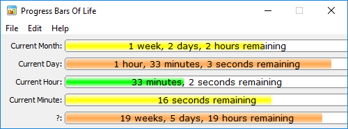

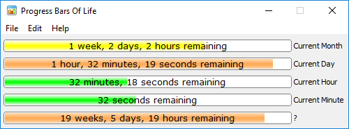

Hi Mouser!
Just happened to be tinkering with PBOL recently, noticed some possibly odd behavior, and saw this thread with a new beta version. Tried the 2.07.00 beta, but still seem to be seeing the same thing, which is where the right edge of the bars always seems to extend past the right edge of the window, regardless of size, when I have captions on the left and "Full width bar panels (one per row)" selected for "Sizing". (Also have "Equalize widths" checked). Important to point out that if I switch captions to the right, no problem.
I can't recall exactly, and haven't yet tested (but will), but I don't think from a fresh (portable) install this was happening, I think it's only after I started adjusting appearance settings and trying out other skins. But not 100% sure. Will try with a fresh copy and see what happens.
Captions: Left
Captions: Right
« Last Edit: May 20, 2020, 05:34 AM by dnm »

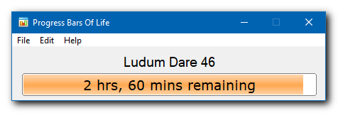

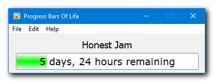

More weirdness:

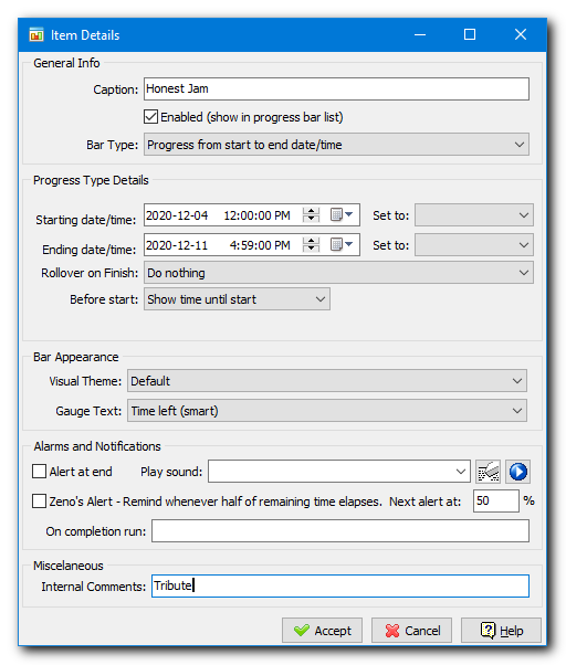

Here are my settings:
Do a search in the WordTest.txt for things that don't make sense, such as "24 hours" or "60 minutes" and you will see plenty of results:
534 matches for "24 hours"
102 matches for "60 minutes"
