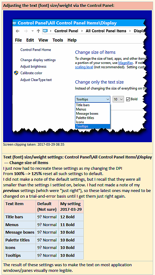

I know that you have been focused on and put a lot of work into getting your apps to respond nicely to changed DPI settings, but from my perspective, ergonomically, changing the DPI setting is likely to be worse than useless.
I don't use/change the DPI setting - it stays at 100% (which is "recommended").
One can see why it's recommended if one does change the DPI setting. For example, as a test, I just now changed it to 125% (125% was the only alternative setting that the system allowed me to do). It was a constipated process. I had to do it using the CursorRight key  because dragging the slider didn't work as the setting just kept snapping back to 100%.
Having made that change and after I had logged off/on again, the visual effect of the changed DPI setting (125%) was grotesquely apparent and about as subtle and ergonomically useful as hitting the display with a brick - so one can see why it's recommended that it be left at 100%.    >:(
Furthermore, changing the DPI expunges all/any customised system Settings for text settings (see example below), and resets them to default. So, after going back to DPI 100%, one has to tediously, manually set them to one's preferences again.
Interesting point:
  • Experience of experimentation with these settings leads one to the discovery that they would seem to be far more useful than one might at first have thought.
  • They seem to be far superior to and more flexible and make much better (more efficient) use of the display "real estate" area than messing with the DPI, which latter should evidently be left well enough alone for laptop displays (QED) - unless one absolutely has to change them as a last resort for some reason.
For interest, here is a copy of my notes on the system settings pane that I refer to above:
It seems to me that, at the moment, the "best" solution to fix the problem of excessively miniscule fonts in these configuration panes would seem to be to change the mode of the pane so that the user can either (say):
  • (a) adjust the fonts and colours of the pane (which could do the job quite nicely, just like in the CHS GUI), or
  • (b) (as a provisional workaround) zoom the pane in/out, with the zoom level being remembered for when that pane is next opened by that user.
« Last Edit: March 28, 2017, 07:31 PM by IainB »

Ah, sorry, I am not "...hoping to be able to customize the font settings in each individual application". I think it's a PITA. I would love it if the DPI settings change helped, but it doesn't (QED). So far, the only alternative that actually usefully works seems to be the path that I have followed - the PITA path. You don't seem to see that, from what you write above and later: "...biting the bullet to get used to the windows > 100% text size may be the way to go, despite it's imperfections.".(?)
Nor do I have a "...desire to completely customize the font settings". as you suggest. Quite the opposite. It's a tedious PITA.
What I do have is a mandatory requirement to be able to easily and rapidly read the screen displays from the apps I use. So I am just using the available, sometimes kludgy, workarounds to be able to maintain  that.
From my understanding, those aren't "imperfections" anyway, they would seem to be serious design flaws that Microsoft has been and is presumably still trying to rectify. One of the biggest design flaws was the Windows 8 OS/GUI fiasco, and they fixed that to a greater extent with Windows 10 (which isn't bad at all, all things considered). This screen display problem would seem to be something of an embedded hangover from that fiasco. Apple computer displays suffer no such problems (never have really), so it's not like it's a technical constraint for the technology available.
Therefore, the correct term would seem to be "design flaw".
At the moment MS seems to have fenced that problem to some extent and not declared a solution path. I feel sure they'll get there eventually.
Meanwhile, when they recommend (as they do) that the DPI setting be left at 100% for my laptop display, I'll heed their advice. I suspect that they probably know better than I what they are talking about there.

All seems to work fine - really well - as per my earlier notes/review for v2.13.01, but I shall report anything new that occurs.
I did have a few very odd problems earlier - after doing the test DPI change up to 125% and then back to 100% (because at 125% it was useless for my purposes).
Notes on these problems:
  • Though I had not made any changes to the sound system, the sound disappeared and Windows Audio service seemed to be stuck in "Stop pending". Could not be fixed and persisted across COLD re-boots of the system.
  • CHS (ClipboardHelp&Spell) persistently and frequently hung without error message and had to be terminated via ProcessHacker. Every time CHS was shut down like that, it would not restart (or would hang soon after restart) if PT (ProcessTamer) was running, so PT had to be closed first, then CHS restarted, then PT started. Rinse and repeat. I guess this was because I had set PT to force the CHS process HIGH, so PT had some residual hooks, or something, into that process. This fun also persisted across COLD re-boots of the system.
  • I fixed it all quite by chance after some trial-and-error. What eventually worked was uninstalling the sound card (which thought it was functioning properly), and doing a COLD re-boot. After re-boot, the sound card came up as present OK but was disabled and could not be enabled. It only worked normally after I did a second COLD re-boot. After that CHS also seemed to work fine and simultaneously with PT, as it should have and had done previously.
All that took a couple of hours (elapsed time) of mucking about, making me regret that I had ever tried changing the DPI settings in the first place. So be warned.    :down:
