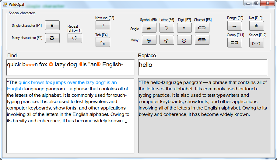

Well, I've got a beta, but stable and fairly polished feature-packed version complete. Love to hear some feedback from pro regex users and people who don't have a clue about how regex works. Even if you're not interested in the unique "unicode symbol" way of doing things, it's a pretty nice regex editor anyway.
Here's a couple of screenshots:
I now know more than I ever expected to know about Regex. Unlike most other find/replacers and regex helpers, "WildGem" (as it is now called) puts the focus on the text you're trying to search in (and the text you're trying to replace). In the end, I kept most of the core functionality that regex provides, but the most common uses are kept at the forefront (e.g: the simple symbol ✪ is the equivalent of ".*?" in regex language and there's a single simple symbol for the messy regex "(?:^|$|\n|\r\n)" which can find the start or end of any line).
And here it is - a single self-contained 53kb exe. No installation necessary, though it does require .NET 3.5 or later: http://www.skytopia....om/stuff/WildGem.exe

« Reply #18 on: June 07, 2015, 09:38 AM »
I think I like it, especially for (regex) n00bs it'll be very helpful, as intended. :up:
A few remarks:
  • Resizing the window isn't very polished
  • The window is quite big, it may not fit correctly on smaller screen resolutions (and then the first item comes in)
  • Tooltip time is rather short at it's default setting
  • You might want to add the regex code inserted by a button into the tooltip, for the more technical/interested users

Thanks and glad your initial impression was favourable!
It was either that, or no resizing. A workaround may be tricky. I mean, I could put it into a scrollable pane I guess...
The width is 1185 pixels. I doubt many are using less than around 1300 pixels of width these days. Still, if someone on this forum is, I'll eat my hat, and try and condense it.
Ah, the developers of .NET would like to talk to you. Anyway, yes I agree entirely, and a (somewhat tricky) fix is forthcoming. In the mean time however, all the info from the tooltips are available in the main help section.
Not a bad idea - I'll consider it.

I must say, I still don't get it.  Those symbols are not regular symbols that one would use on the keyboard, so what is it for?  Is it just a regex builder in the end?
Thanks for the question! I included the special symbols for a few reasons:
1: Each special WildGem symbol can represent two, three or even 10+ regex symbols. I don't want to use the original symbols, as they already have meaning. Something like "the ✪ quick" is nicer than "the .*? quick" ;P
2: They are easier to distinguish with the eye than the standard regex symbols, as they don't look like 'normal text'. Less escapes makes the expression clearer even further. This helps especially for more complicated expressions.
3: You can paste text directly directly into the Find expression without having to worry about escaping any of the characters in said text. The WildGem symbols I use are very rare, and hardly anyone would otherwise use them in day to day work.
Anyway, even if you never use the special symbols, and only use the regex filter, I hope you'll find it's a pretty nifty util anyway. Apart from regexr.com, I don't think anything else has quite this layout where everything is accessible, updates on the fly, and that highlight all regex matches at once in the main text. Be interested to see others programs that can do that if you can find one.

Thanks for the feedback! The non-beta version will be potentially hundreds of times faster (helpful for 100MB or even 1GB+ files!), and will allow the escape syntax in the replacement section too.
The speed increase is due to the Scintilla text component (the one Notepad++ uses!) - so much better than .NET's crappy RichTextBox. Oh HOW I wish I knew about that when I was developing OpalCalc...
