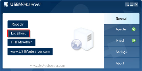

Download this: USBWebserver8.6 + ownCloud ~49MB (~160MB when extracted)  It's on my ownCloud server.
Extract to a flash drive, (make it a fast one), or an empty folder, run usbwebserver.exe, when the interface comes up, choose your language, and then click the Localhost button.
It will open the home page of USBWebserver in your browser, eg.
