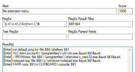

Is this a plug-in or just some methods for tweaking the aliases?
It's an alias. Here is a shorter instruction on how to set it up.
Begin to create a new alias and enter these details:
alias name: file extension menu
regex pattern: ^((.+)\\(.+)\.(\S+))\s+\.(.*)$
regex result filter: $$5 $$4
results:
[Enter] run default prog for -file.$$4 | shellexe $$1
[Enter]  VLC (mkv;avi;mp4) | %programfiles%\vlc\vlc.exe "$$1"
[Enter] / IRFANview -file.$$4 | %programfiles%\irfanview\i_view32.exe "$$1"
[Enter] notepad npp -file.$$4 | c:\windows\notepad.exe "$$1"

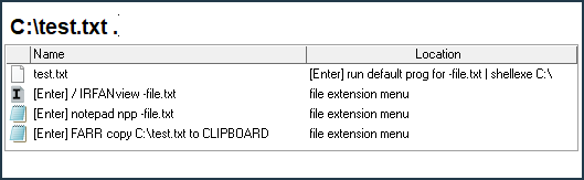

Screenshot
Note: You can pick and choose which results lines you want to use from the rightmost column in the largest table in this post
https://www.donation....msg394054#msg394054
Or create your own using the same pattern.
Once set up use it this way
- Do a regular FARR search.
- Navigate down into the results window and select the file you want to operate on.
- Press Right Arrow Key to fill the FARR search box with the full path to the selected file.
- Press Space followed by . (period).
The FARR results should now list the different actions you can take on the file. Here is how that looks in my FARR.
edit: you can filter the results list of actions by continuing to type characters exclusive to one of the results lines. For example type npp to only show the open with Notepad action.
At least the above steps is how I think it is meant to be used, from a very quick test. I don't use it myself.
