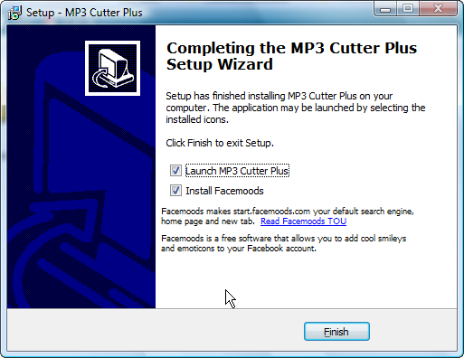

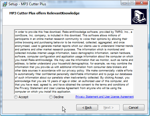

-made by A Software Plus, who is linking to Brothersoft. However, the author's name is Vishal Gupta - a name I believe I have seen in many other freeware programs of simple but absolutely fair quality. Beside a link to his own all-in-one program, Media Cope, this installer comes with default option for both comScore RelevantKnowledge and Facemoods:
sajman99
  • Posts: 664
...this installer comes with default option for both comScore RelevantKnowledge and Facemoods...
Cripes, thanks for the heads up. :o Back when I used the app (IIRC), there was none of this add-on crap in the installer.
