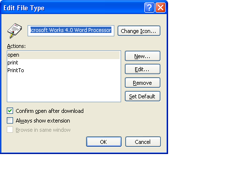

Did you reboot after rebuilding the cache? If not, it's worth a try. Also, as Curt mentions in his post you could try taking a look here (my screenshot is of the *.doc filetype but the same applies to any other):

yes I did try a reboot but that didn't help.  I also check the file associations and it was set to a works 4.0 word processor type.

several applications seems to have a preference for the WPS extension. since f0dder has already mentioned about changing within Windows and that didn't work for you (see pic). maybe WAssociate could be of help here.

here are some screenshots showing file association for wps.
