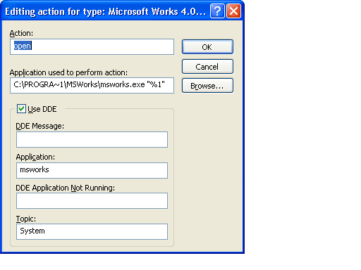

yes I did try a reboot but that didn't help.  I also check the file associations and it was set to a works 4.0 word processor type.
she does have some word docs (not many) so it would be easier for her to tell the difference by looking at the icon.

« Reply #10 on: August 12, 2008, 09:02 PM »
here are some screenshots showing file association for wps.
