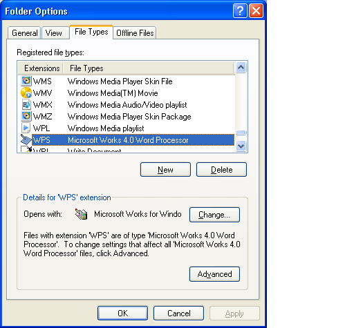

several applications seems to have a preference for the WPS extension. since f0dder has already mentioned about changing within Windows and that didn't work for you (see pic). maybe WAssociate could be of help here.

here are some screenshots showing file association for wps.
