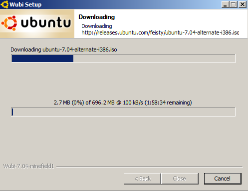

The Wubi program is a mere 9.9mb, but you will need the most recent ubuntu alternate iso.  You can either download it youself and put it in the same directory as Wubi before you run it, or you can have the program download it for you.  I chose to download it myself from a close mirror rather than letting the program download it.

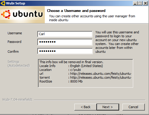

The Wubi program will ask you for a usename and password for the initial Ubuntu account (the usename field will prefill with your Windows usename).  At this point, the program will extract the iso into three virtual disk files in C:\wubi, which are mounted using a loopback when you boot into Ubuntu.  These three disks took +7gigs on my computer.  It will also modify your boot.ini file and drop some grub files into C:\.

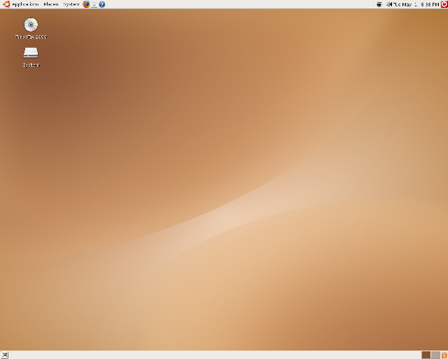

At this point, Wubi is done with the Windows part of the job, so you need to reboot to let linux take care of the rest.  Reboot the computer, and get ready for the magic.  You will see the Microsoft bootloader come up with Windows and Ubuntu listed (and anything else you have in your boot.ni).  Select Ubuntu and sit back as Grub takes over and boots.  The text-based installer will kick in and install your linux system.  Once it is done installing, you have a working Ubuntu that you can boot to whenever you want.

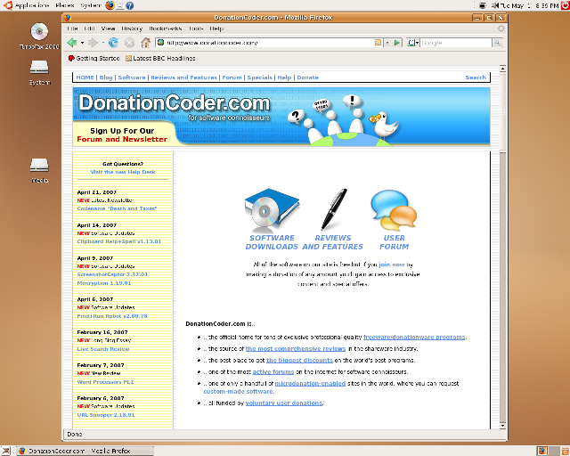

Everything is just like it would be with a standard install.  Straight away, you will have read access to all of your data on your NTFS partitions, and the Wubi Guide gives instructions for enabling write access.  All changes made to the linux installation are retained in the virtual disk files that Wubi created.  The Wubi Guide gives instructions for adding more virtual space.
Screenshot.pngMini-Review: Wubi - Painless, partion-free WindowsXP/Ubuntu dual booting  DC.pngMini-Review: Wubi - Painless, partion-free WindowsXP/Ubuntu dual booting
My PC is pretty old, so it's no surprise that all my hardware worked right away (your milage may vary).  Gnome is a little slow on my old clunker, so I fired up the package manager and installed xfce.  Also, I was getting Opera withdrawal within minutes, so I installed that as well.

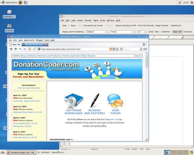

xubuntuoperaoo.pngMini-Review: Wubi - Painless, partion-free WindowsXP/Ubuntu dual booting
At this point, everything seems to be just like a standard Ubuntu install.  From here, you would refer to your friendly neighborhood linux guru for assistance.

When installing, Wubi asks you for a usename and password for the initial Ubuntu account.  The field is automatically filled with your Windows username (and according to the bug list below, it doesn't matter if you try to change it).  My username is my first and last name (Carl Thorpe).  When Ubuntu had booted and was installing, it told me that Carl Thorpe was not a valid usename.  It would be better if the installer caught that and asked me for a different usename.

"The Wubi program will ask you for a usename and password for the initial Ubuntu account (the usename field will prefill with your Windows usename).  At this point, the program will extract the iso into three virtual disk files in C:\wubi, which are mounted using a loopback when you boot into Ubuntu.  These three disks took +7gigs on my computer.  It will also modify your boot.ini file and drop some grub files into C:\."
Does this mean that I must have +7G free in C: ?
Is it possible to choose that to be placed in one of my other partitions?  I try to have a relatively small C: with only Windows and my MOST common programs, that can be quickly backuped and replaced.
