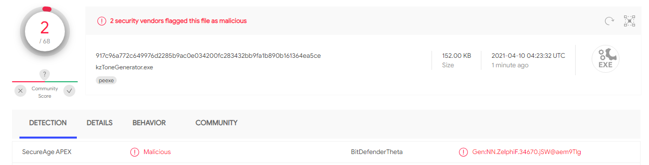

VirusTotal results:
I am sorry for two false-positives.
