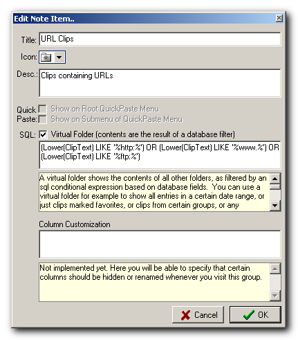

Suppose you want a clip group which shows you all clips containing a url..
Create a new group in the group tree, and edit it (F2), and set the values as follows:
The key here is to check the "Virtual Folder" checkbox and fill in this text:
(Lower(ClipText) LIKE '%http:%') OR (Lower(ClipText) LIKE '%www.%') OR (Lower(ClipText) LIKE '%ftp:%')
That tells CHS that this group is constructed dynamically from all other clips that match the specified rule.
Now whenever you select that group you will see all clips from all other groups that contain http or www. or ftp:.
You could customize it as you want of course.

just tried out this potentially useful feature. but there's a problem because it captures normal sentences containing keywords such as 'http' or 'ftp'. is there way to add a rule to say that if source of capture is from browser's location bar then show in this folder.
no but
how many times in a normal sentence are you going to type http:
you could change it to http:// if you wanted to be a bit more precise.
ok, sounds logical. then how do i modify the rule to say if only starts with 'http', etc?
it already does say that
but you could change
(Lower(ClipText) LIKE '%http%') OR (Lower(ClipText) LIKE '%www.%')
to
(Lower(ClipText) LIKE '%http://%')
that will probably reduce the false positives.
