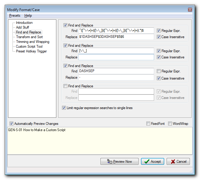

ok this is a bit convoluted, but should work in CHS:
go to the search and replace tab and you will create 3 entries in this order:
First, a regex one:
Find: ^([^\-\+]+)([\-\_])([^\-\+]+)([\-\_])([^\-\+]+)(.*)$
Replace: $1DASHSEP$3DASHSEP$5$6
Next, a regex one:
Find: [\-\_]
for Replace put a single space
Lastly, a non regex (though shouldnt matter):
Find: DASHSEP
Replace: -
What this does: Changes the first two dashes (or underscores) into the word DASHSEP
Then Replaces all remaining dashes/underscores into spaces
Then puts back the first two dash/underscores with dashes (note that if the first two were an underscore they will change to dash).
screenshot:
Note:
You might still be better off learning to use a simple scripts with CHS because that would allow you to tweak things like this and do more complicated stuff.

Wow mouser thanks, it worked perfectly.  I'm a huge fan and love Find and Run Robot and CHS.  Don't know what I'd do without them.  Thanks again.
