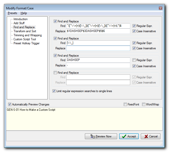

I'd like to take a file name with "-" or "_" in between words and replace them with normal spaces. This is caused when I download files from Share Points. But, only after the 2nd occurrence of the string in a standard document naming convention.
Examples:
I want to change "GEN-S-01-How-to-Make-a-Custom-Script" to "GEN-S-01 How to Make a Custom Script"
I want to change "GEN-S-01_How_to_Make_a_Custom_Script" to "GEN-S-01 How to Make a Custom Script"
I'd like to just type it in the Find and Replace, Find field in the Modify Format/Case tool versus making a Custom Script Tool (which I think would be way over my head).
I tried to fool around with regular expressions, but have no experience and failed. Thanks in advance.
Examples:
