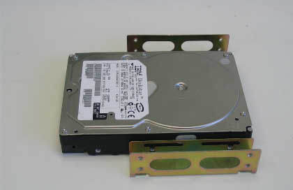

Option 1: Obtain a set of 3.5 to 5.25 adapter mountings and move the SATA HDD to just below the SATA optical, this would allow the SATA optical to be powered also.
This is a pair mounted on a HDD, then you just screw the HDD into a 5.25" slot.

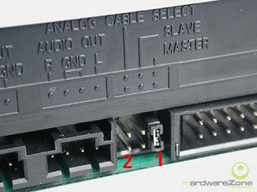

On the back of the Maxtor there is a small jumper block something like this, (red star over it):
NOTE: The jumper block might not look exactly like this since they changed the style a few times, you'll need to tell me the exact model number so I can find a diagram.
The back of the optical drive will look like this, (thankfully they're pretty standard):
What needs to be done for both the Maxtor and the optical is to move the jumper from whatever position it is currently in to the position marked CABLE SELECT, (or CS, CSEL).
On the optical picture I've marked it as the number 2, the jumper is the little thing marked 1.
This is normally a pretty easy thing to do, a bit fiddly when the drives are installed but certainly doable with a bit of patience and some needle nose pliers - the most fiddly will be the optical drive since the jumper block is on the other side of the IDE cable, (when viewed from the photo perspective).  A good light and a magnifying glass might also be of benefit or a really friendly neighbour with good eyesight and a steady hand.

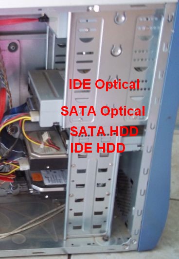

What SJ proposes is this:
1) Remove the IDE optical, (*).
2) Move the SATA HDD, (1), to where the arrow points, (bay 4), using only two screws on one side to hold it.  This should be fine if the machine is not moved around a lot.
3) Move the SATA optical, (2), to bay 3.
4) When those two SATA devices are in position then you'll be able to plug the extra SATA power connector, (3), into the back of the SATA optical since it should reach from the SATA HDD.
Optional for neatness:
a) Move the IDE connector, (4), to the IDE HDD.
b) Put the IDE optical in bay 1 to plug the hole, but don't bother connecting it up.
It would be best to unplug the SATA cables, (both data and power), from the devices before moving them.  Try to avoid waggling them up and down as you unplug or plug them in.  They are polarised and the data connector is smaller than the power connector, looking at the back of the device you have the power connector on the left, the data on the right.
When you remove the SATA optical, (slide the opticals out through the front of the case), take the time to study both the plug and socket so you're familiar with how they go together.
