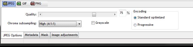

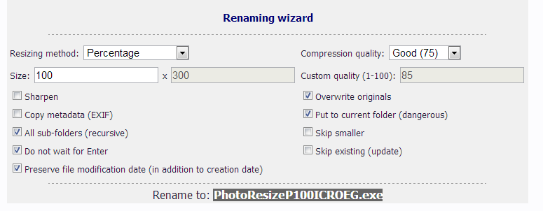

I think where I am having difficult and need your help desperately is to find the "sweet spot" for JPEG optimization.   Am I wrong to assume that RIOT has some magic algorithim for quality/size ratio?
These are the settings:
0. I do NOT want to mess with the dimensions!!
1. Remove all meta dataa (EXIF, comments, etc)
2. 75% quality
3. Chroma subsampling 4:1:1 (????)
4. Standard optimize (not progressive)
5. Preserve file modification date
This is the name that I got: PhotoResizeP100ICROEG.exe
Please confirm if this is the correct name matching what I got. I am going to do some basic tests and compare file sizes/quality

I am using:

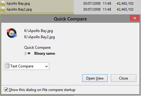

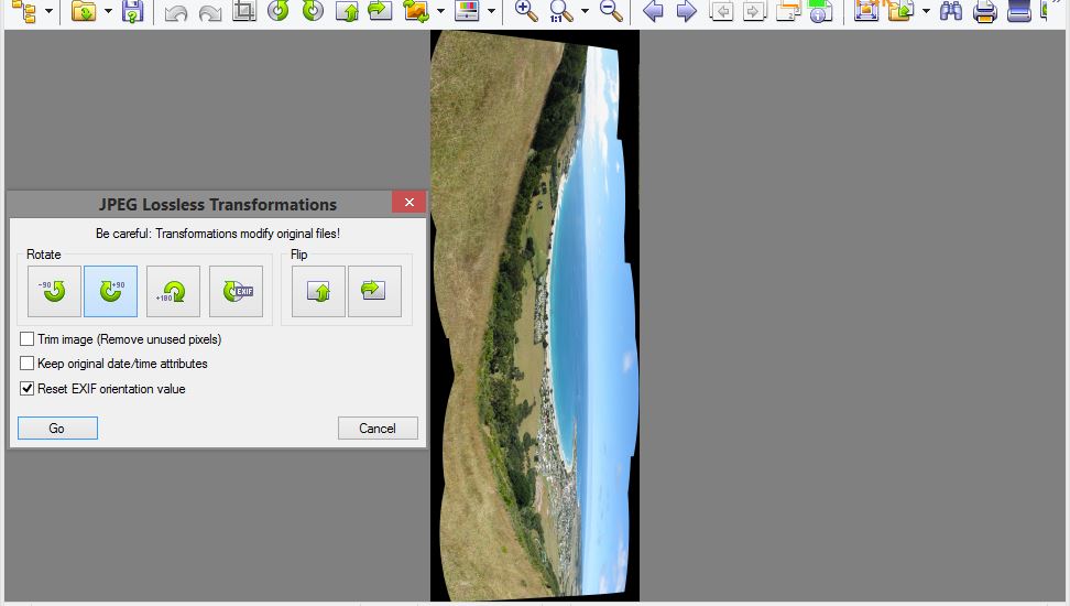

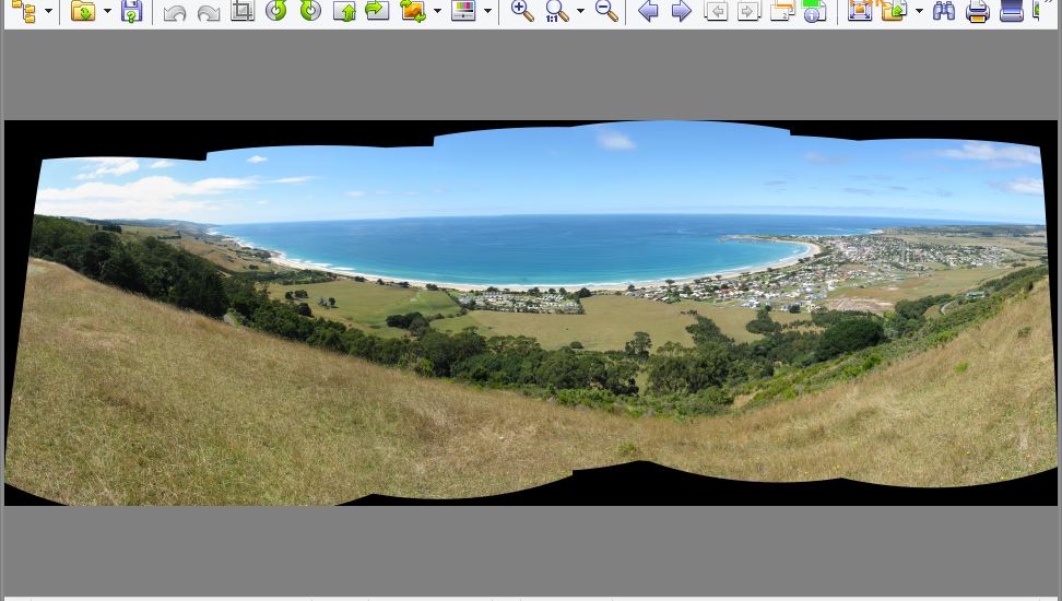

Since you haven't attached an image that's giving you problems, this is the one I'm using to test, so the following are just screengrabs of the results of each step:
1) Original (42,465,102 bytes, 10358x3803 pixels 300DPI)
2) Step 1 - compression with PhotoResizeP100ICROEG (6,587,712 bytes, 10358x3803 pixels 300DPI)
3) Step 2 - Rotation using XNView 2.32, Lossless 90° Right (6,570,854 bytes, 3803x10358 pixels 300DPI)
As you can see, the picture is rotated and the file size decreased after rotation.
