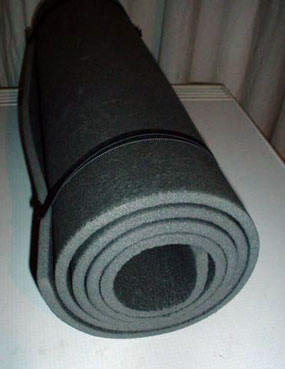

For anyone experiencing a similar annoying hard drive hum, this is the material I've used: http://en.wikipedia....rg/wiki/Sleeping_pad
I've cut several small rectangles out from the foam so that each hard drive rests on four of these layers. This is something I shall do in future (as it works better than anything else so far) - but it requires a more secure way of restraining the drives. It's fine whilst the machine is stationary, but if I were to forget about the hd foam bed setup I could easily have hard drives smashing around inside the case when I try to carry it somewhere (I've stuck a post-it note to the side of the case to remind me about the unstable contents - yes, I am likely to forget otherwise).
Good for sound reduction, but what are the effects on temperature? Sleeping pads are made for insulation...

Good point. But I did leave out a few details which, I think, mean there's nothing for me to worry about.
1. The hard drives are still in their Antec metal trays (which have rubber grommet anti-vibration things for the screws, but obviously don't work to reduce the annoying hum). These metal trays are resting on the foam pads - so there is a gap between pad and hard drive.
2. Both hard drives are directly behind a fan at the front of the case.
Either way, the insulation issue is worth remembering, i.e. now I won't be tempted to do something stupid and wrap the drives in lots of foam padding to try and wedge them into the case.
