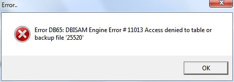

and upon starting it up was promptly presented with

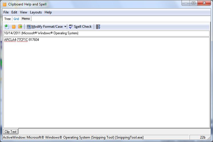

clicking OK dismissed it. I get the same error EVERY time I left-click on the tray icon. Bringing up the main window give me a bad looking one

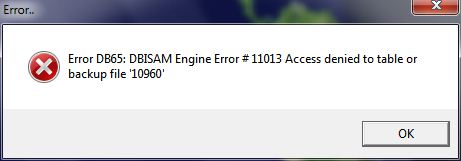

so I closed down CH+S. Upon restarting the program I am presented with
and clicking OK dismissed it. Again, every time I left-click the tray icon I get
I'm going back to the version I loaded yesterday because it was working perfectly fine.

Maybe you can try the different temp file settings tweaks you tried before?
Im 99% certain these problems are related to a security software locking the temporary files, if you can only disable the scanning inside the folder you configure for the temporary access, that should solve it (of course that doesn't help others)

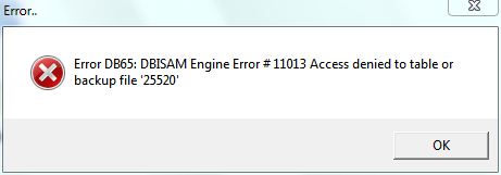

Bringing CH+S up the first time after the new install it throws
and throws this every time I left-click the tray icon, too.
Shutdown and restart CH+S gives me this upon starting
and every time I left-click the tray icon.
