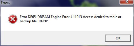

I don't know what you did, but you went backwards. Just downloaded "latest" version per your request
Mark and spknapp,
Can you download the latest alpha and give that a whirl?
and upon starting it up was promptly presented with
clicking OK dismissed it. I get the same error EVERY time I left-click on the tray icon. Bringing up the main window give me a bad looking one
so I closed down CH+S. Upon restarting the program I am presented with
and clicking OK dismissed it. Again, every time I left-click the tray icon I get
I'm going back to the version I loaded yesterday because it was working perfectly fine.

Maybe you can try the different temp file settings tweaks you tried before?
Im 99% certain these problems are related to a security software locking the temporary files, if you can only disable the scanning inside the folder you configure for the temporary access, that should solve it (of course that doesn't help others)

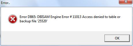

Nope. Still no good, no matter what I set the temp file tweak setting to.
Bringing CH+S up the first time after the new install it throws
and throws this every time I left-click the tray icon, too.
Shutdown and restart CH+S gives me this upon starting
and every time I left-click the tray icon.

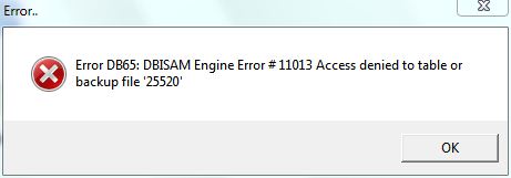

I uninstalled the version that works good, and installed your latest version. Immediately on startup it threw
I clicked OK and it went away. I then went into options to change the tweak Temp Directory setting and when I clicked "Accept" I got
followed by
Left-clicking on the tray icon gives me
every time I left-click on the icon. When I open the main window it looks wrong
I have exited and restarted CH+S with the same reults.
This is the same thing that has happened the last three times I have tried your "latest" versions.

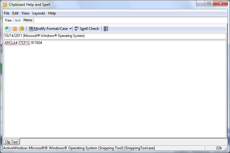

Downloaded the latest alpha version per your 6:20PM post.  Just ran through a quick sequence of capturing clips. No problems. Dragged and dropped clips between folders in the tree. No problems at first. However after clicking around a half dozen or so times on different folders in the tree I began getting multiple access exceptions. Once they were all dismissed I was unable to switch to a different folder. Exited and restarted CHS. Was able to recreate the same problem. Exited and restarted CHS again. This time the grid window looked like this...
Just had to try it one more time...restarted CHS the grid window looked as I expected it to...
