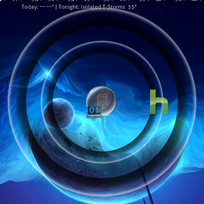

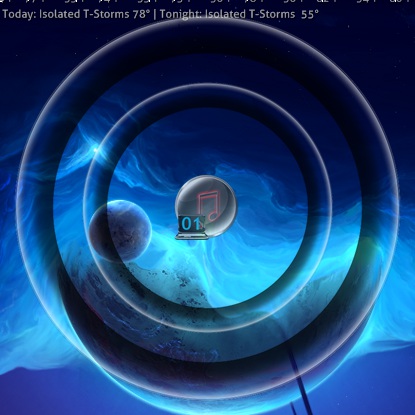

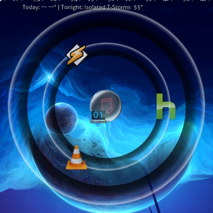

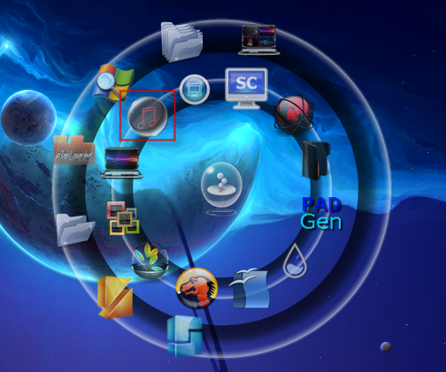

So based on the following Video:
You are looking to make This Icon (Highlighted in Red):

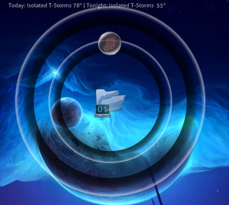

So that it will do this:
Is this what you are asking, or something similar???

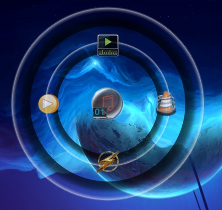

Ok, so we want the following:
So we get this:
Believe it or not, this is simply a folder with a custom Icon, and label.  8)

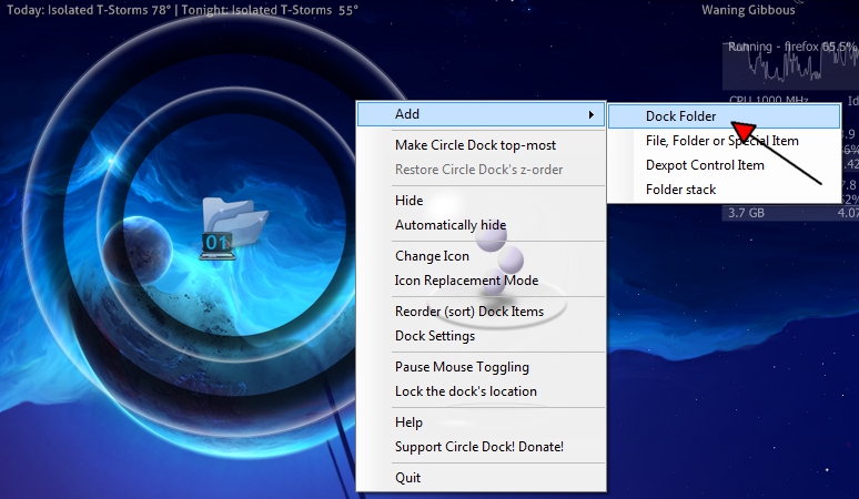

So to reproduce this;

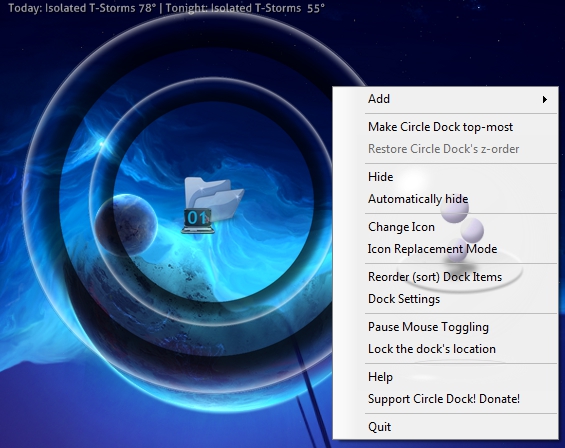

1.) Right click on Circle Dock and bring up the Context Menu
2.) Go to Add > Dock Folder
Click on Dock Folder

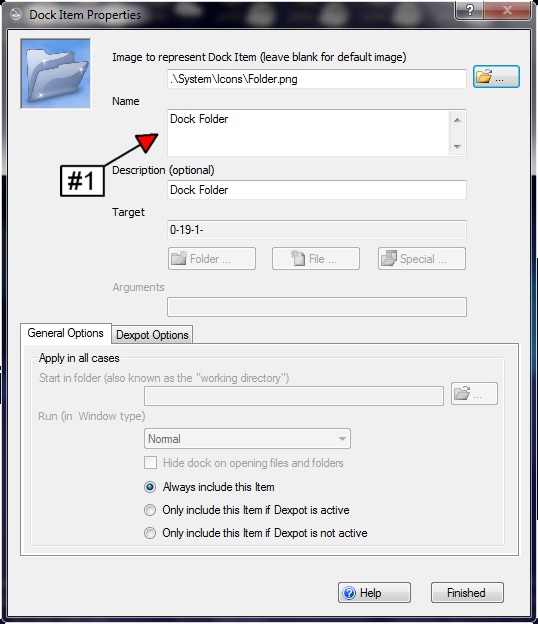

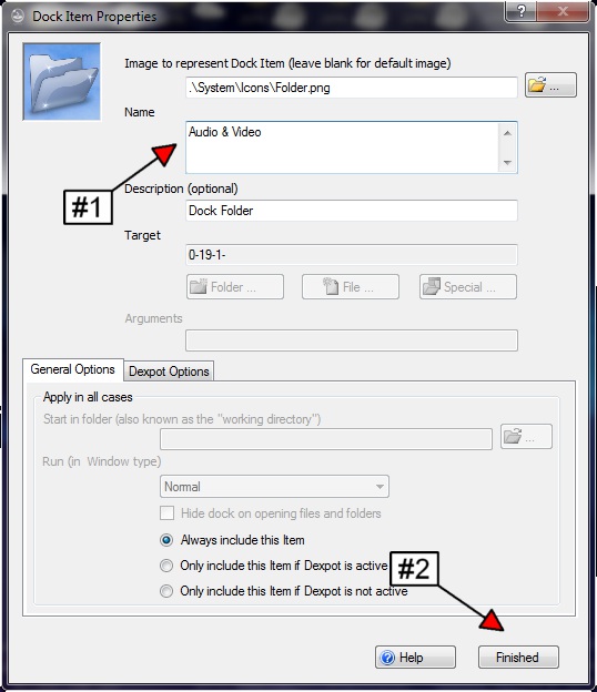

3.) Wait for the Item Settings dialog
In the area marked #1 in the image above is where we want to give the new folder a name. I will simply Call Mine "Audio & Video"
You are welcome to name your folder in whatever you like  :Thmbsup:
4.) Once we have named our new folder, Click Finish (Area #2 Below):

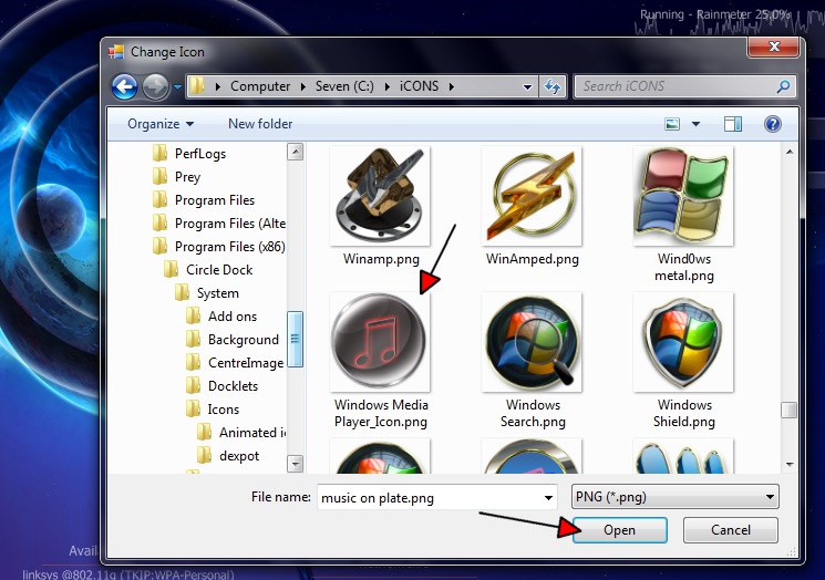

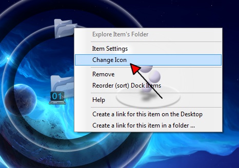

5.) Now lets give our new folder a custom identifiable Icon
Right Click on your new Folder and click on Change Icon
6.) This will bring up a window so that you can search for the location of your custom Icon  ;)
Once you find the Icon you want, select it, and then click on Open
Now we have a new folder with our Custom Icon  :Thmbsup:

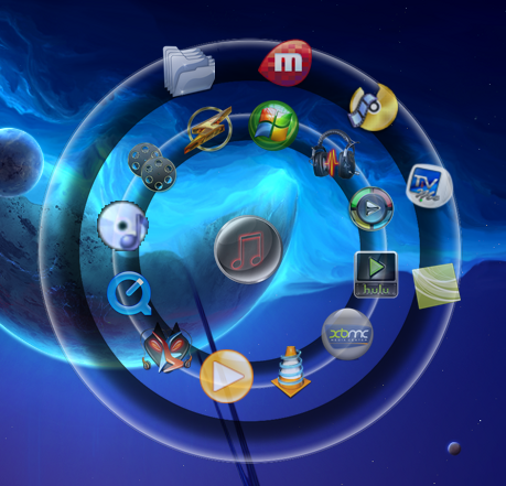

Now that we have our new custom folder, we need to populate the folder with Audio and Video programs to Launch
So lets start by Double Click our new Folder and we will find that we have a blank Circle Folder to start with  ;)
Now lets add some Shortcuts to Audio and Visual Programs

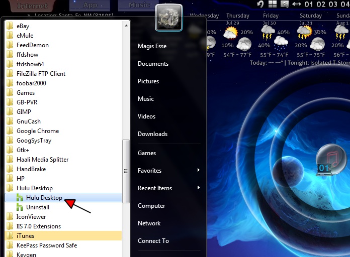

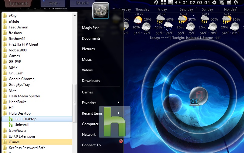

So to this, go to the Start menu > All Programs, and find the First Program that you want in this new folder.
I will start with Hulu Desktop.
So
1.) Go to Start > All Programs and scroll through the list till you find your Program(s)
2.) Simply Hold down the left Click button on your mouse and then drag and drop the Program shortcut to Circle Dock

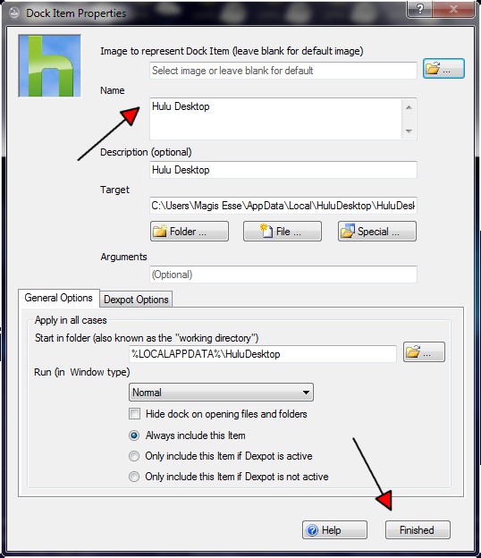

3.) Once you have Dragged and Dropped the shortcut to Circle Dock, you will get an Item Properties Window for the new Shortcut.
Check the Name of the shortcut, and make any changes you desire. Then click Finish
NOTE:
If you get a Window that asks if you want to delete the old Icon, select NO!!!
Now we have our new application Launch Shortcut ready to go.

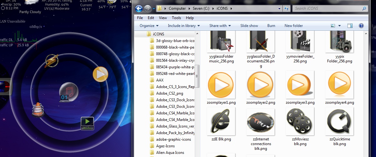

BUT; I want to add a program that is Portable, or at least I keep portable. This program does not appear in the Windows start menu so I need to follow a different method to get the Shortcut I need  8)
For me I will go to the Start Menu > Computer and then navigate to the folder that has my program. In this case I want Zoom Player
Now all I do is Drag and Drop Zplayer.exe to Circle Dock.
This will bring up the Item Properties Window.
Since I do not want Zplayer to appear as the name of this shortcut, I must Change the name to Zoom Player  ;)
As above in the previous examples; Once you have changed the name, and made the adjustments you want, click Finish

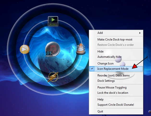

Changing Icons using the Icon Replacement Mode:
1.) Right Click on Circle Dock and bring up the Context menu and then go to Icon Replacement Mode
2.) This will bring up a Window for you to search out your Custom Icons. I keep all of mine a singular file, so that I know where to find them.
3.) Simply Hold Down the left Click Button and  Drag and Drop the Custom Icon over the existing Icon.
The current Icon will be replaced with the new/Custom Icon
4.) Now go ahead and Repeat steps 1 through 3 to add custom icons to the rest of your shortcuts.
Selecting custom Icons of your choosing as you go ;)
Visuals  :D
5.) once you are finished and satisfied with the Icons that you have for your shortcuts. Close the Window that was brought up when the Icon Replacement Mode was started
6.) Now Right Click on Circle Dock and bring up the Context Menu.
Make sure that you TURN OFF Icon Replacement Mode
Otherwise I guarantee that you will be having a fit when you go to add a new Shortcut, folder, or file  :tellme:
And there we have it. A freshly created Folder with Freshly created Shortcuts, and we have added Custom Icons that can be readily Identified ;)
