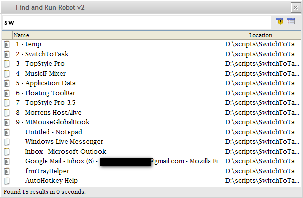

QUERING THE TEXTFILES

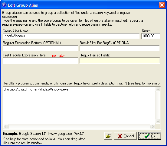

To query the textfiles I created 3 aliases. We issue 'IndexWindows' whenever we want up to date information. We issue 'sw <part of windowtitle>' to query window titles. IndexWindows is created just for ease of use: it simple calls the indexing script we created:
1000>>>IndexWindows>->d:\scripts\SwitchToTask\IndexWindows.exe

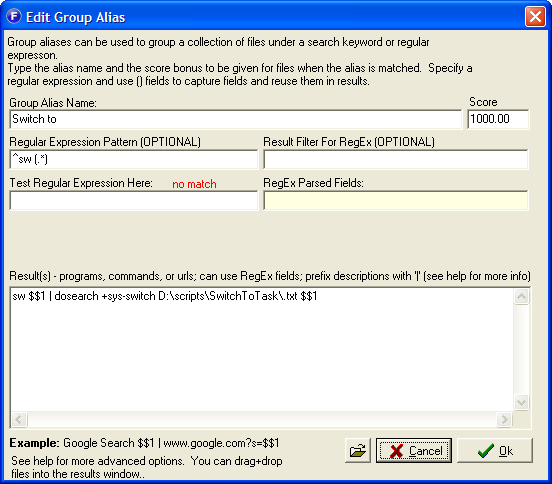

The third and last alias is a bit more complex. (Thanks to mouser for helping me with this) It does a new search with the sys-switch alias for any textfile in the Storage directory:
1000>>>Switch to>->sw $$1 | dosearch +sys-switch D:\scripts\SwitchToTask\.txt $$1>+>^sw (.*)

SOURCE & FINAL THOUGHTS
I was still polishing these scripts when FARRAltTab was released so at the moment it has some problems with window titles with invalid filename characters in them such as ':'. Also I'd have created some kind of FARR alias writer helper app so the person wouldn't have to know the path of the helper apps. Etcetera. However I think it is a nice proof of concept for the creative thinkers that want to use Autohotkey or any other language to harness the power of FARR.
