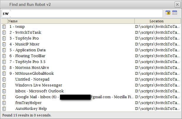

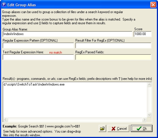

To query the textfiles I created 3 aliases. We issue 'IndexWindows' whenever we want up to date information. We issue 'sw <part of windowtitle>' to query window titles. IndexWindows is created just for ease of use: it simple calls the indexing script we created:
1000>>>IndexWindows>->d:\scripts\SwitchToTask\IndexWindows.exe

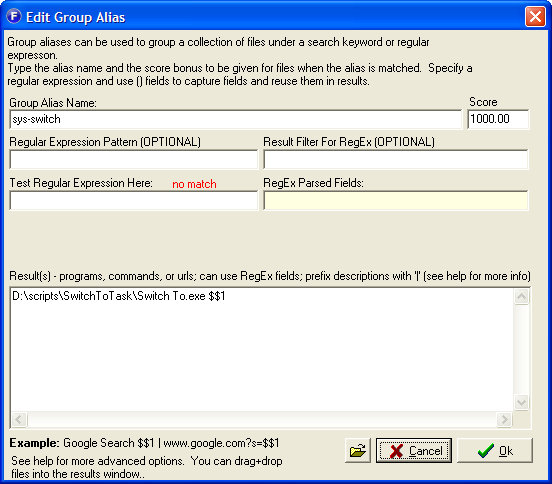

The 'sys-switch' alias is a system alias (the user never has to know about it) that runs a query as a parameter to the switching script we're creating later on:
1000>>>sys-switch>->D:\scripts\SwitchToTask\Switch To.exe $$1
The third and last alias is a bit more complex. (Thanks to mouser for helping me with this) It does a new search with the sys-switch alias for any textfile in the Storage directory:
1000>>>Switch to>->sw $$1 | dosearch +sys-switch D:\scripts\SwitchToTask\.txt $$1>+>^sw (.*)
