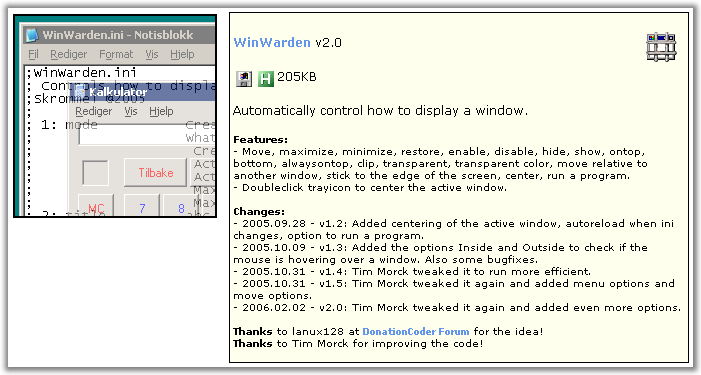

i can understand your problem because i have launchbar commander docked at the top and the same thing happens to me.. :) but there is already a cure for that - Skrommel's WinWarden.
• http://www.donationcoder.com/Software/Skrommel/#WinWarden
• http://www.donationcoder.com/forum/index.php?topic=757.0
