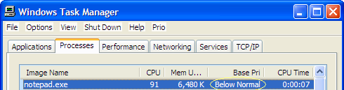

I started Notepad.exe with "below normal" priority.
I opened a big heavy file that demands high CPU usage.

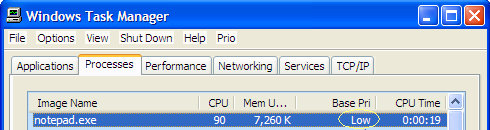

This will trigger PT to Decrease the process priority to "low" priority.

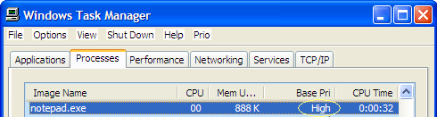

But instead PT increased the priority to "Normal" and after a while to "high"
