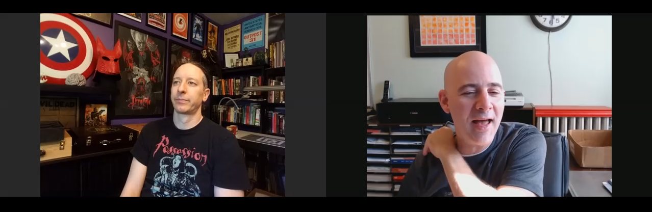

Original video recorded by zoom looks like this:

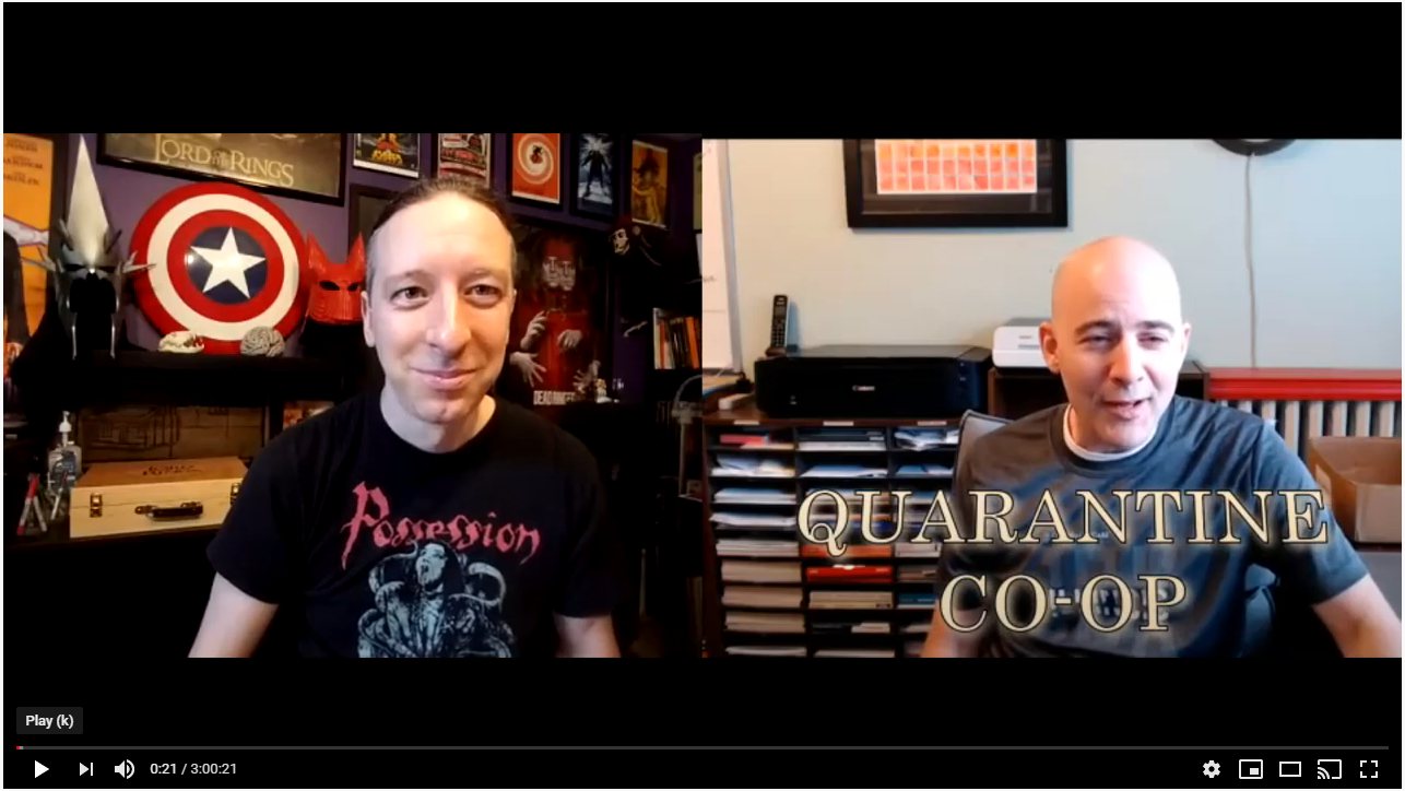

Result:
Basically it tells ffmpeg to form a new frame by selecting out each of the two images and then combining them side by side.  You could use similar ffmpeg command to stack them on top of each other, etc.
