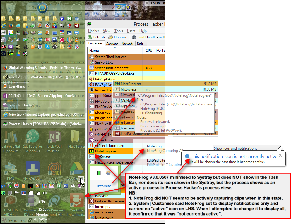

I am providing the screenshot not so much as to describe an apparent error/bug, but rather to demonstrate how useful Screenshot Captor can be in problem analysis cases like this - where "a picture is worth a thousand words".
The picture is comprised of a sort of collage of different screenshot bits, starting with the first - which was of the Task Bar and Process Hacker window (which were side-by-side) - and then overlaying other screenshot clips and adding a text box and arrows, and expanding the canvas in SC (Objects-->Expand canvas to fit objects).
I'm sure I could have made it look nicer, if I took the time, but the thing is it would have been difficult for me to do this without using SC. SC really is a superbly crafted and useful tool for such purposes.   :Thmbsup:
The only constraint in using SC in this case seems to be in taking any screenshot of an area of the screen which contains a system pop-out window - and there were 2 such instances in this case. SC couldn't take such a clip without closing the pop-out window first, every time I tried it. The Windows Snipping Tool and the ABBYY Screenshot Reader weren't any better, but the OneNote Screen Clipping tool did the job just right as it freezes the on-screen display as soon as it is invoked, allowing the user to take their time to frame the section clip.

This is in Win8.1-64 PRO, using Classic Start Menu's Taskbar to pop up the little Systray "Show hidden icons". In Customise, there was another information pop-up - all as captured by OneNote, in the image above.
