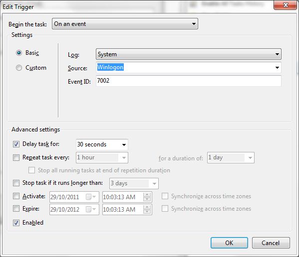

BTW, the trigger event required is: System->Winlogon->7002

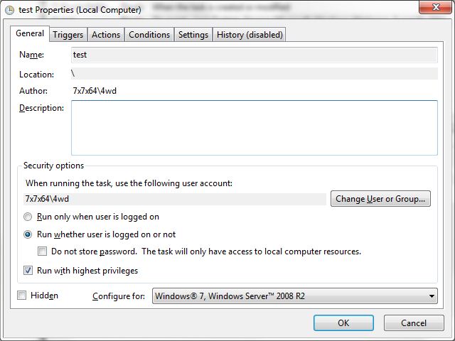

1) Open Task Scheduler and select Create Task (right side of window).
2) Give the task a name, set to run whether user is logged on or not, run with highest privileges - you'll need to enter your account password before leaving this page.
3) Edit the Trigger as follows:

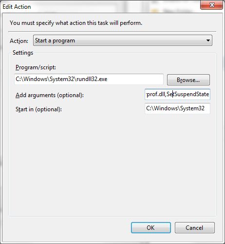

4) Create an Action as follows:
The complete arguments line is: powrprof.dll,SetSuspendState

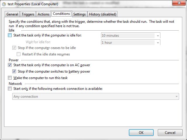

5) Set the Conditions as follows:

BTW, if you don't want to have it do it all the time then under the Conditions tab you might try setting Computer Idle timeouts and to stop it if it ceases to be idle.
Set the Task to run after the computer had been idle for x and cancel it if someone causes activity, eg. logs on.  Setting an idle timeout here probably means you should remove the 30 second timeout under the Trigger tab.
