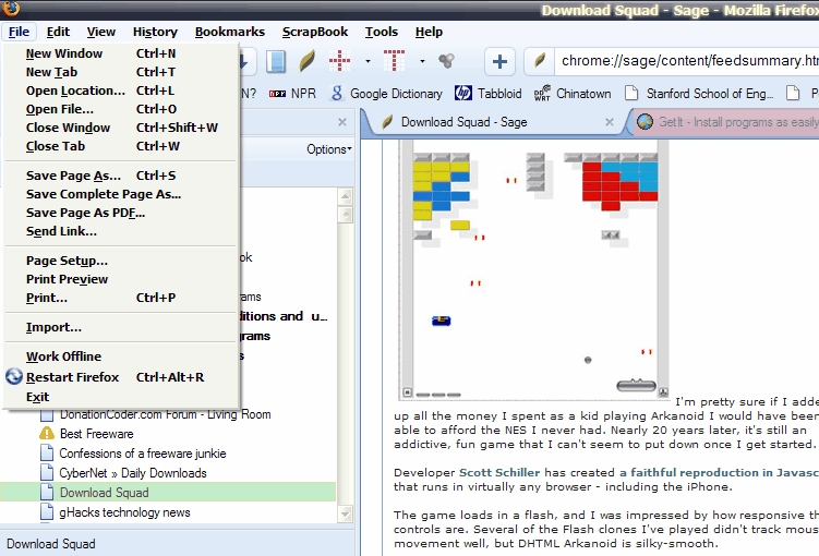

For Screenshot Captor, from tray menu you can toggle the delay capture mode and autocapture mode (set times in options dialog):
