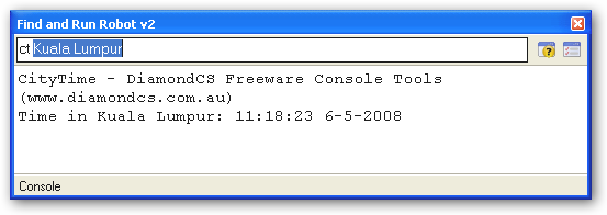

great work, czechboy! this works quite well. i'm testing this with a tool called CityTime and here is the output. :Thmbsup: btw, the note about the "&&" is an important clue. next, i'll try to make this work with an alias.

after some tinkering, i've managed to get this working via alias and it get very interesting now as all cli tools that "displays info and exit" can now be routed this way in a nice Farr memo window. check out the screenshot and thanks again czechboy! 8)
as advised by mouser, i've re-packed czechboy's Console plugin with the citytime files and (exe and alias) so that you only have to unzip into Farr's "Plugins" folder to get it working. btw, for those not wanting download the whole thing, this is the code that triggers the plugin:
1000>>>citytime>->ct $$1| dosearch cn "%FARRDIR%\Plugins\Console\Citytime\citytime.exe" $$1 &&>+>^ct (.*)

Note to alias writers who might want to use this alias pack as a template for their console-based aliases: This alias, as designed by lanux, uses the "dosearch" functionality, which results in an immediate execution of the console program with every character you type.  Works well in this case but if you are going to shell out to a command that takes a while to run, you would want to use the Console plugin differently.  You can use "restartsearch" keyword instead of the "dosearch" keyword to have it ONLY run the console plugin+exe when the user hits enter.
