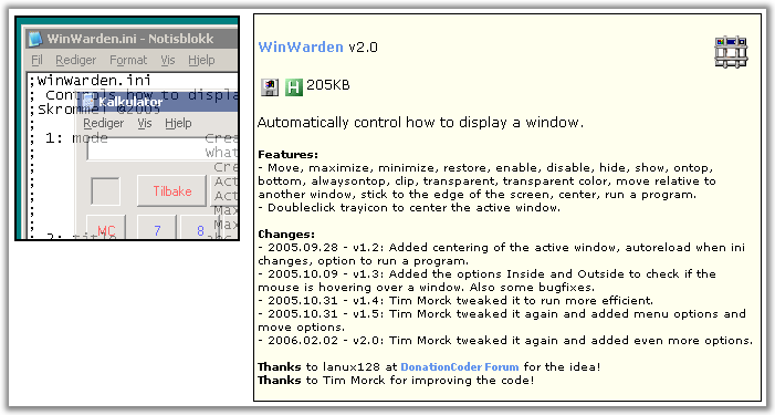

you can also use WinWarden for that. check out this thread..
Force PPTView.exe to always show on secondary monitor
According to that discussion, it doesn't work when the monitors are a different size.  In my case, one of them is a TV and that is 640x480.
After some experimentation, I have concluded that the warning about monitors being the same size doesn't apply when the window is small and fits on both.  But I still had trouble.
I have posted by experiences in the original thread above.
Thanks -- Vincent

I've surrendered and switched my secondary monitor to the right.  Now WinWarden works fine for me.  (Also Opera now pops-up its you've got mail message on the primary monitor -- a problem with left secondary monitor that I had not told you all about.)
Thanks to all for all the help -- Vincent
Kruskal: glad to see that sorted out.. sometimes simple solutions are the best.. :)
Well it didn't turn out so great because WinWarden doesn't recognize that I have told it to display on non-existent territory when I am in single monitor mode.  Maybe my situation isn't typical, but I switch a lot -- I only use dual monitors when I am watching media and have a TV available.
I think I'll just give up on the whole thing.
WinWarden would have worked despite this using a left secondary if it worked in that case at all since I would be telling it to place the window at a low X position and that would exist in either case.
Thanks for your good wishes -- Vincent
