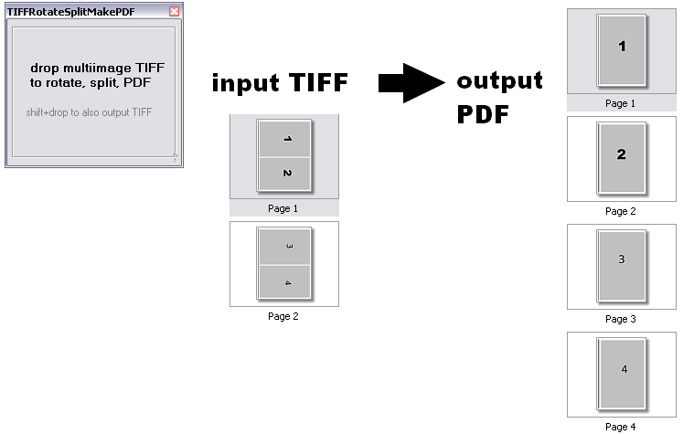

TIFFRotateSplitMakePDF v090314, http://nod5.dcmember...atesplitmakepdf.html
by Nod5, with help from ewemoa
input: multiimage file.tif with two scanned pages per image (= a bookspread, tilted 90 degrees)
what the script does: rotate 90 degrees, split each image in two (L/R page), output file.pdf with all split images in page order
tiffrotatesplitmakepdf.zip contains .exe , .ahk (source) and md5 hashes. made in Autohotkey. requires: http://www.imagemagick.org/
Thank you ewemoa!  :Thmbsup:

TIFFRotateSplitMakePDF v090315, http://nod5.dcmember...atesplitmakepdf.html
v090315: ctrl+drop to skip rotate
« Last Edit: March 14, 2009, 08:35 AM by Nod5 »

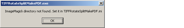

ImageMagick directory not found. Set it in TIFFRotateSplitMakePDF.ini
But I have edited this file w/ complete path.
Pls help
thanks

The default ini is a bit confusing - you have to remove the comment character ( ; ) in it. Check if you've done that. So this won't work:
;imagemagickdirectory=C:\program files\ImageMagick-6.5.0-0
this works:
edit: I've now updated the program so that the comment character from now on never gets added to the ini:
v090319 ini bugfix
