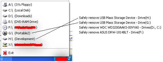

I wrote myself a tray app a while back that when right clicked displays a list a of all drives on the system with their drive spec and name. It was originally so i could open drives fast on systems where i had to use the start menu. I'm afraid that's the only way I've ever managed what you're talking about.

My reply was ambiguous. To omit the unnecessary details, i have an application that shows me the names of all my drives against the drive letters. Basically, looking at this list allows me to match the name of the drive i want to remove with the letter, then i can use the windows safely remove hardware wizard.
