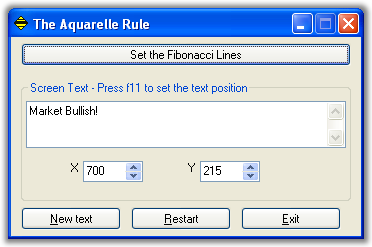

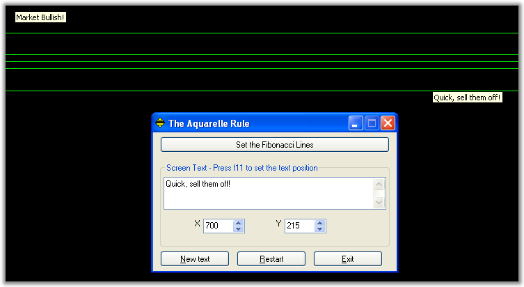

to be honest, i don't know what is this but i just downloaded it to have a look and it looks cool... 8)
anyway, it is lacking screen-shots, so i'm posting a couple of them..
Fig. A: Main window
Fig. B: Desktop with the added Fibonacci lines
P.S. doublebogey, this looks like a birdie.. ;-)

1. Keep the box on screen (First version) giving a choice to: Draw, Redraw and Exit.
2. The 2 buttons are a very nice additions!  But, as I said before, all the lines SHOULD be visible on screen wherever the buttons are placed, whether left or right of each other.
3. One "last" request... I think  ;)  Is there a way to offer a choice between the "regular lines" (those between LOW and HIGH), and the ones above-below the buttons?  What I mean is that I don't always need the "above and below" lines, which could be hidden somehow (or not shown). Or maybe offer a choice (check) of "between" and/or "above".  I don't even know if that is possible!
1. The box is back.
2. Lines work all the time, but remember that the calculation is based on the 'high' being above the 'low'
3. Checkboxes to show/hide lines inside and outside.
small bonus extra - choose the colour of the outside/inside lines.
Have fun
dB
