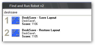

btw i noticed another program that could do this - DeskSave and it works quite ok with Farr.
