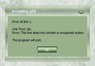

« Reply #13 on: October 07, 2008, 01:42 AM »
Screenshot...
Happens when I try to run ahk script
