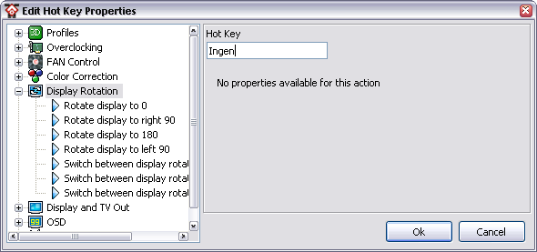

if you have an ATI graphics card then the utility ATI Tray Tool (ATT) might work: http://www.guru3d.co...le/atitraytools/189/ .
It is free, supports screen rotation and can be set to use any hotkey you want.
And if you don't want it running all the time you could make an AHK script that, when a hotkey is pressed, launches ATT, sends the screen rotation hotkey, exits (and on next hotkey press toggles back). You could also easily add a step where some additional tool saves/restores the desktop icon positions (ATT can save/restore icon position but if I remember correctly it's not possible to do that through a hotkey)
