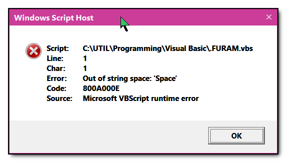

I had been having a similar problem, but it was regarding running a VBS file. The file had just one line in it. It worked repeatedly just fine, if triggered (double-click) as a .VBS file from Windows Explorer or xplorer² and if triggered via a shortcut from either of those. However, it wouldn't run at all from LBC or FARR - kept giving this error in both cases:
So, I did as you suggested above, re LBC:
...Can n you try this: Go to the topmost "Options" tab and change the setting you have for "Use file launch helper" -- see if that makes a difference?
That setting was empty (not ticked), so I ticked it, and now the script works just fine when triggered in LBC. I realise (from the Options tip in LBC) that changing that option might enable or disable effective triggering of other files via LBC (depending on other factors), so I shall see what transpires, but at least I now know how to enable the .VBS file to be triggered via LBC, so, thankyou.
