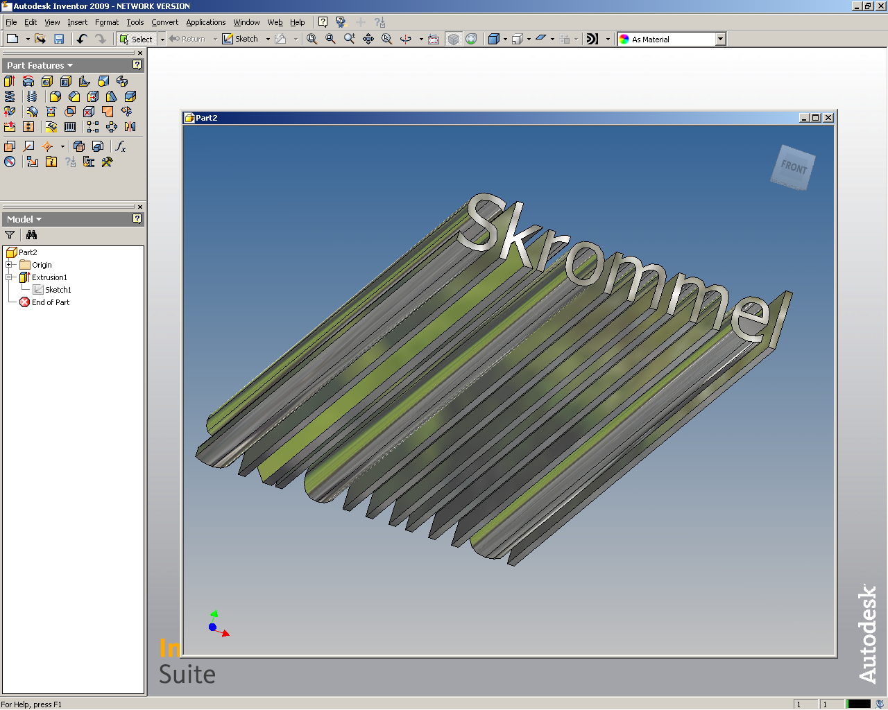

Hey!
I would like to have a small program that will allow a user to stretch a given region of the screen (a window and/or control) to fill the entire screen and then "unstretch" it back to its original size and position. The program wouldn't need a user interface of its own, hotkeys would probably suffice. More specifically, I need to stretch a window in Autodesk Inventor which is a 3D CAD program and give the user the ability to show only the 3D model on the screen without any of toolbars, buttons, taskbars etc. that clutter the working space. This program would be of equal interest to many other 3D packages (That don't have this feature already) or other software. It's main intention is for presentation purposes where you want to clean the screen for distracting elements. I suppose this could be accomplished by hiding the regions of the screen that are not of interest, but I am looking for something that will make maximum use of the screen real estate.
I have experience with AutoHotkey but I haven't been able to find a suitable solution. I've tried a few different approaches so far:
-Set the size of the control to be equal to the screen size and set the control to be the topmost control.
This didn't work because the control is a child of the parent window (Autodesk Inventor) and I couldn't set the size of the child control to be larger than the size of the parent window. The control is stuck inside the parent window.
-Detach the control, set its parent to a new gui and set the size of the gui to be equal to the screen size
This is when I came across Skrommels DetachVideo. This seems to be very promising and a great starting point. Extending and modifying DetachVideo to detach and stretch any control would do the trick nicely. One issue with this approach is that even if all keystrokes and mouse clicks are "forwarded" to the parent window, the parent window has "lost control of the control" so the program might not function properly?
-Create a separate window which magnifies the original control
This might work as well, but I couldn't get things right and ideall I would like not to distort the image (zoom). If nothing else works then this will suffice.
Related links I've come across:
Similar request for program
SetParent function (make a gui belong to another window)
holomind's ScreenMagnifier
I've attached some pictures showing the Autodesk Inventor main window.

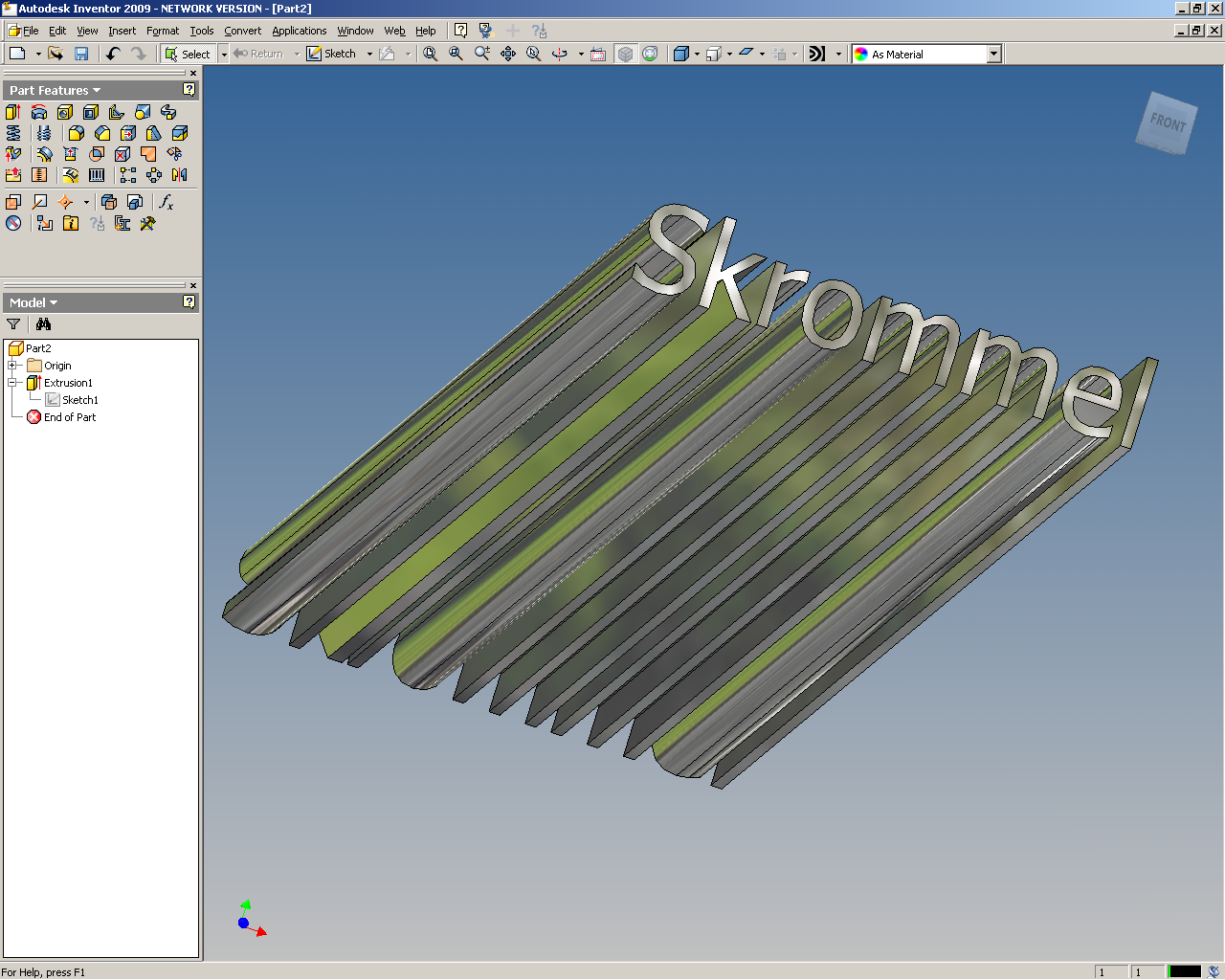

  • The first image shows the standard window with the window of the 3D model maximized inside the parent window.
  • The second image shows the standard window with the windows of the 3D model "restored" inside the parent window.

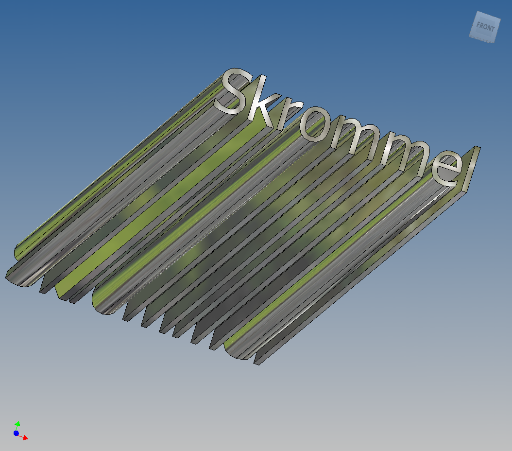

  • The third image shows what I want the full screen to look like. This essentially shows the entire goal of the program

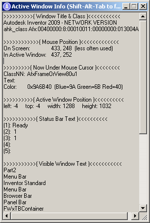

  • Snapshot from WindowSpy
Can this be accomplished?
Thanks in advance.
Murple

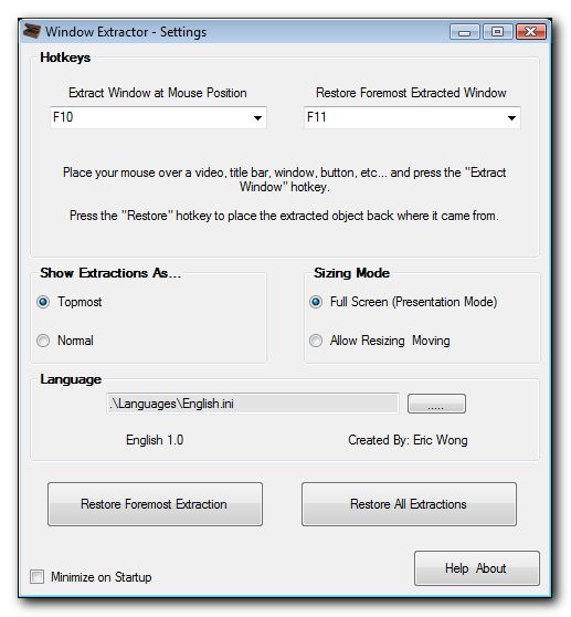

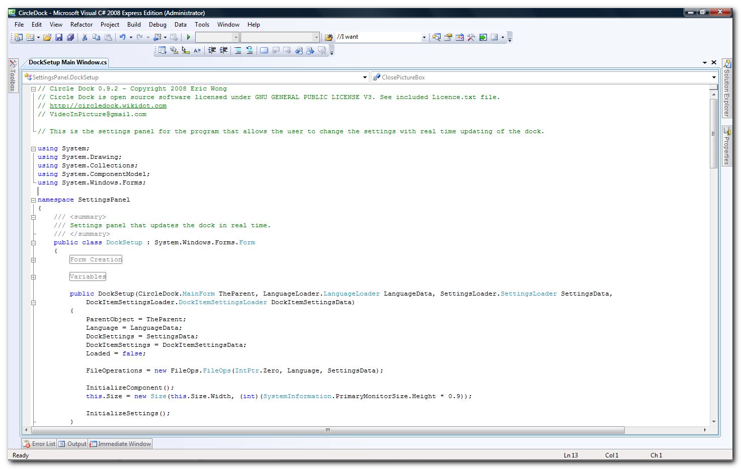

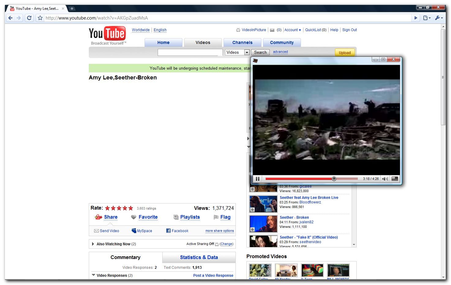

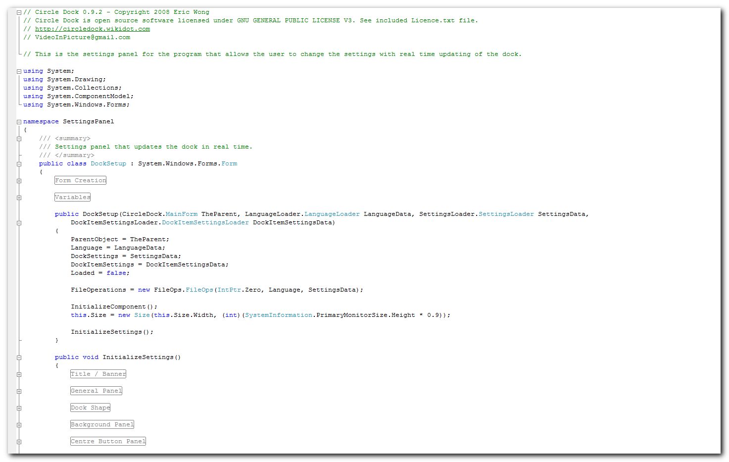

I've coded a program called Window Extractor that will allow you to extract those windows in your CAD program and make them full screen with no borders and you should still have some of the normal functionality of that window, such as rotating and zooming in objects.
You can also use it to extract YouTube video's like with Detach Video. I'm not sure if anyone else is having a problem with Detach Video where it isn't replacing the video in the same spot that it came from, but I find that Window Extractor pops out and replaced online videos reliably and in the same place it comes from. I've tested it on IE, Firefox, and Chrome.
Window Extractor is actually able to extract any object in Windows that has a window handle. However, not all programs allow for extractions without crashing so it is best to test it out before use on a presentation.
Window Extractor is written in C# and the source code in on the website: http://windowextractor.wikidot.com. You need .Net Framework 2.0 or later to use it.
* Window Extractor is activated by using two hotkeys that can be changed in the settings panel.
* Hold your mouse over a video or window title bar and press F10 to extract it.
* Press F11 to restore the extracted object.
Eric Wong

There was a little bug in the language loader of Window Extractor 1.0 and I have released version 1.1 to fix it: http://windowextract...wikidot.com/download
On some computers, version 1.0 may not properly load the language files because it was using a short hand version of the file paths. Version 1.1 uses the complete paths for the language files.

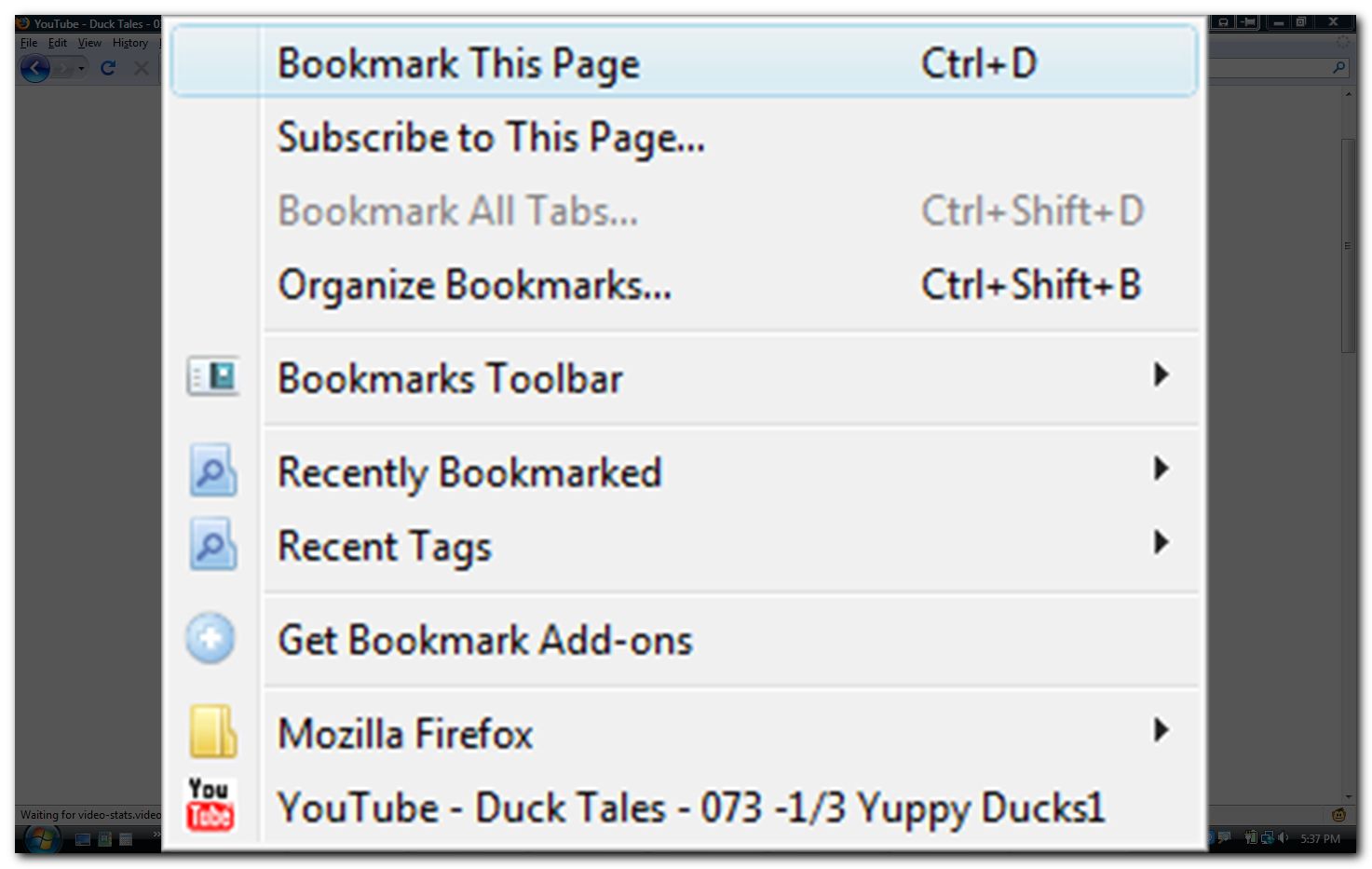

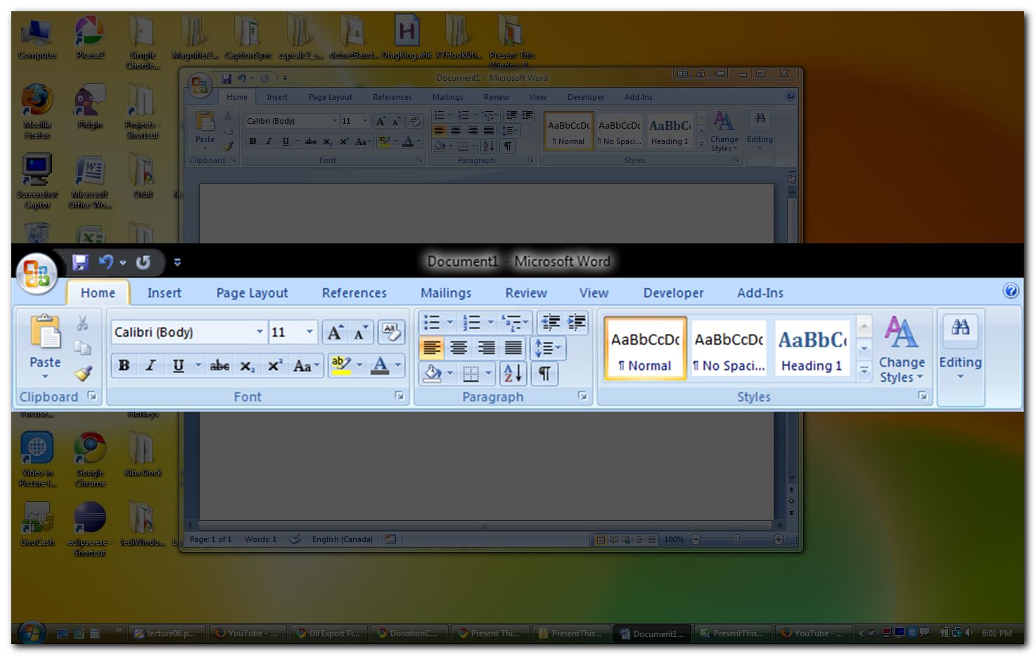

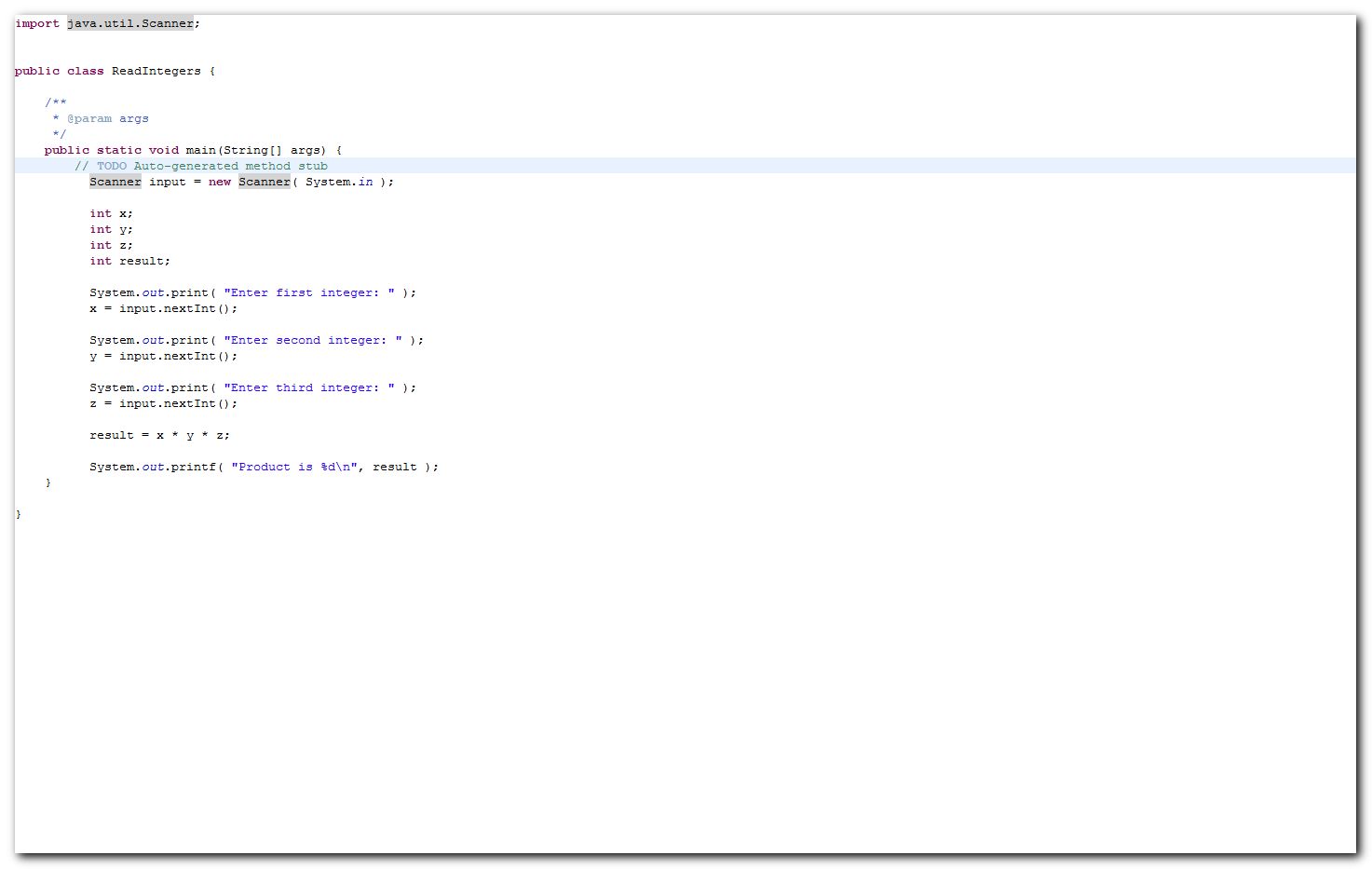

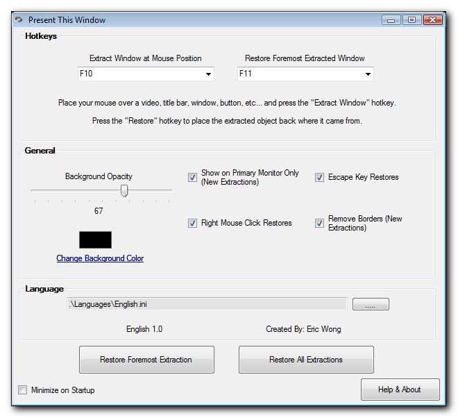

Got the second program coded: Present This Window. This one will take a static screenshot of an embedded or standalone window and present it to the screen. This one won't crash since it doesn't change anything about the original windows.
http://presentthiswindow.wikidot.com/
Word_Regular.jpgIDEA: Toggle Fullscreen of Control1
Word_Ribbon_Presented.jpgIDEA: Toggle Fullscreen of Control2
Firefox_Boomarks_Regular.jpgIDEA: Toggle Fullscreen of Control3
Firefox_Bookmarks_Presented.jpgIDEA: Toggle Fullscreen of Control4
Present_This_Window_V1.0.jpgIDEA: Toggle Fullscreen of Control5
Present Embedded & Standalone Windows From Programs
  • Present This Window allows you to quickly take a screenshot of embedded or standalone windows and present them in a pleasing manor. The screenshots are shown without title bars or borders and is automatically sized to fill up as much of your screen as possible.
  • Places a translucent background behind the screenshot to provide better contrast. The color and opacity of this background can be changed.
  • Great for presentations where you want to show off a CAD drawing, accounting spreadsheet, or other software that don't support a fullscreen mode.
  • Can be used in conjunction with ZoomIt from Windows Sysinternals for a very professional and complete presentation system.
  • It is open source and the code is available for download.
  • Present This Window is activated by using two hotkeys that can be changed in the settings panel.
  • Hold your mouse over a window or window title bar and press F10 to present it.
  • Press F11 to close the screenshot of the presented window. Alternatively, you can right-click on the screenshot or press ESC to close it.

VideoInPicture: Am I the only person that refers to you by your nick? In any case I wanted to congratulate you on both "Window Extractor" and "Present This Window", I'm very pleased that others have realised their usefulness.
Unfortunately, neither seem to do the trick for Autodesk Inventor: Window Extractor makes it crash, and Present This Window creates a "static" fullscreen presentation, whereas I hoped to be able to continue to interact with the window and its controls and make it a "live" fullscreen presentation. Window Extractor really was perfect for this purpose and it might also be that it works with older versions of Autodesk Inventor.
On another note, since these programs are almost identical in use and function wouldn't be completely natural to combine the two into a single Fullscreen Presentation program with two different "modes"?
VideoInPicture
  • Posts: 467
    • Circle Dock
Re: IDEA: Toggle Fullscreen of Control
« Reply #22 on: October 09, 2008, 02:50 AM »
You can call me either name, I'll respond to both.  :D
I don't know if I can get Autodesk Inventor to display it like in your OP because of that crashing issue. I think we should get Skrommel in on this and see if he has any ideas that can help. Perhaps we could make the static image click through to the original application?
Also, can you post a screenshot of Autodesk Inventor with all the toolbars hidden and try to get the window you want to display as large as you can?
It would make sense to combine Window Extractor and Present This Window, but I found it easier just to program Present This Window separately from Window Extractor so I didn't have to worry about the settings. However, I will combine them in the future.
