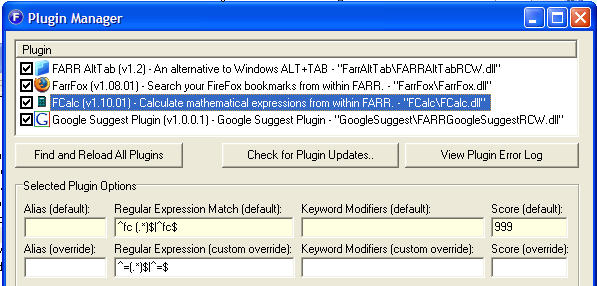

Well, a month has gone by and I have never sorted this out.  I don't know if I have changed the "default name" or not (image below).  I did change the Regular Expression so it would open on "=".  But it does not come up one the list if I type "fc" or "fcalc", so when I hit enter from inside fcalc (by habit) and hope to stay in fcalc, I get dropped out to the FARR command line with "fc" typed in and unrelated results in the result list.  Is it somewhere else I would have changed the default name (and could change it back)?  Should I not be using "=", or is there not a way to use "=" and have the "fc" trigger fcalc to restart?

When I mentioned "default name", I meant the "alias (override)" field. Sorry for not being specific :(
Yeah, but changing the Regular Expression has that same effect.
This is indeed a problem that can only be changed by modifying fcalc, so I'll let mouser answer.

Is there a regular expression that would basically say "either = or fc"?
Re: new farr: aliases now requiring [enter] twice
« Reply #6 on: July 16, 2008, 06:04 PM »
You're a genious ottenm! Of course, just use:
^=(.*)$|^fc(.*)$
That should work perfectly.

Oh yeah, that feels good.  Enter.  Expression.  All day long.  This is going to be a good second half of the week.
