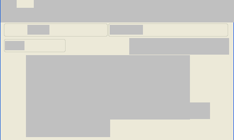

Anyway I've had a bash at programing a solution. See attachments...
My solution uses the the TransColor command. Silver pixels in the "Trigonometry Calculator" window are transparant and reveal only the desired features in the Calculator below.
But there are a few problems.....
1. How do I ensure the Calculator starts Scientific mode?
2. How do ensure that the "Trigonometry Calculator" (TC) is always directly above the Calculator and when the TC is moved the Calculator is also moved and stays directly below.
3. How do I prevent users turning off the Calculator (ie. by right clicking it's icon on the task bar)?
4. How do I close the TC and the Calculator Simulataneously?
I'll have a go at tackling these issues over the next few days but I wouldn't mind some suggestions.

Attached is the latest version.
Now there are three problems remaining to be solved.....
2. How do I ensure that the "Trigonometry Calculator" (TC) is always directly above the Calculator and when the TC is moved the Calculator is also moved and stays directly below?

Cover.bmp is a grey rectangle W230 H170:
Run, %SystemRoot%\System32\calc.exe
WinWaitActive, Calculator
ControlGet, hWndNewParent, Hwnd,,, Calculator
WinGetPos, X, Y,,, Calculator
x:=X+55
y:=Y+140
SplashImage, cover.bmp, B X%x% Y%y%
ControlGet, hWndChild, Hwnd,,, SplashImage
DllCall("SetParent", hWndChild, hWndNewParent)
Sleep, 10000
SplashImage, Off
I'm try to get the SplashImage to move with Calculator when I drag Calculator.
What did I do wrong?
« Last Edit: October 15, 2006, 06:33 AM by Uncle John »

The approach I exploring now avoids the Calculator window being de-activated or moved by:
- Closing all windows b4 starting the Calculator script,
- Hiding the Task Bar,
- Removing the Calculator Menu Bar,
- Placing an Splashimage over the Title Bar.
Here is the code. As you can see the "close all windows" part has been commented out for convenience while I'm trying to fix/develop other parts of the script:

I'm trying to work out how I can make a transparent hole over the Calculator Close button because you can still drag by clicking on the right hand edge of the title bar. Does anyone know how to make a hole in a SplashImage?
I'm also trying to get multiple SplashImages working. Only the title bar cover works at the moment. Doublebogey are you there? Do you have any suggestions on this?
