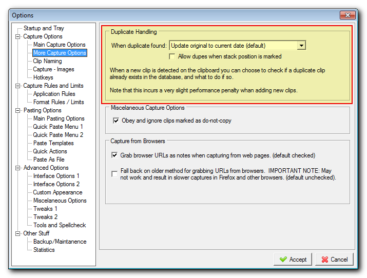

I have noticed that MS excel this can happen also -- its happening maybe because these MS Office apps are doing something strange.. perhaps copying to the clipboard in two separate events in quick succession, for some reason I don't understand.  Or perhaps CHS is trying to read the clipboard before the app finishes with it..
Here's something that may fix it.  I've added a new option to increase the delay between the triggering of a clipboard event and CHS acting on that trigger, so that 2 quick success triggers will only result in the final capture:
As I said earlier, the other fix which will be available in a future version of CHS will be if the clips are duplicates except for a one or two irrelevant data formats, to mark those formats as IGNORE or IGNORE-FOR-PURPOSES-OF-CALCULATING-UNIQUE-HASH.
Other possible solutions would be: Having a list of applications that CHS should increase delay-before-capture behavior, or some kind of smart process to overwrite the previous clip when the subsequent one happens in super fast succession.
« Last Edit: February 21, 2020, 08:25 PM by mouser »

Can I actually compare two clips in this 'Interrogator'
There is no explicit compare function -- it's just the list of formats and hash values you would compare manually.
So what I'd like you to do is look at the two *seemingly* duplicate entries within CHS and view the database views of the blobs from the interrogator window, and see what's different in the interrogator list of formats for those two clips.
Can you show me screenshots of the interrogator for each of the two clips?
It's EITHER going to be the case that the clipboard blobs are different, or that CHS has a bug in dupe detection.
With the same vector drawing and delay set to 500ms -- one clip gets copied.
So I think that probably suggests that your having that same problem with apps that put a lot of info on the clipboard where CHS first grabs the clipboard and then the app adds more info and chs has to go again.  As before, there are a couple of options here -- either forcing a longer delay for CHS from some apps, or some process where i auto-delete the prior copy when there are 2 in close succession.

I'm going to go ahead and move the clipboard capture delay option up to a more prominent location in the "More Capture Options" tab, and add an explanation for it; that will make it easier for people to notice.
